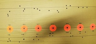

I did not get all of my fireform loads shot but I do have enough cases formed to start load development. I have a ocw test loaded up. We have a target stand set up at 300 yards so I think I will jump right in and shoot there. I need to bring my scope up as my slow fireform loads are hitting 7" low at 300. Load details are formed Federal 270 cases, WLR primer, 140 grain Berger VLD moly seated .010" off of 0 jam over 52 to 55 grains of N165 in .5gr increments. I am hoping to shoot tomorrow morning and I will post some results. Have a good weekend fellas.
Just got home from shooting. Had a good session. 30° and full sun with just a hint of left to right breeze. This is the OCW test from 52 to 55 grains of N165. Absolutely no pressure signs so I will load up another round and see where I find it. No elevation adjustments were made. I did take 4 clicks right between 52.5 and 53 and 2 more between 53 and 53.5. Mirage was too bad so I shot this at 200 yards rather than 300. I can see a node starting between 54 to 55 so I will flip this target and reshoot 55 to pressure and see how they print before I mess with seating depth at all. Let me know what you think.

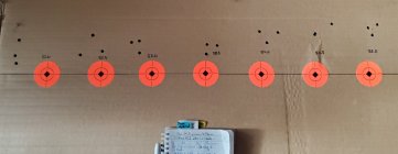

Shot again today. I kept going up from 55.5 to 58.0 grains of N165. Shot at 200 yards again and there was no mirage. A slight wind from the 4 oclock position didn't move my impacts much. I did not adjust my scope from the last session but I may need to for the next one or just set up a new target. It is nice having the full process on one board though. Anyway, what do you guys think? I haven't found pressure yet but my velocities leveled out from 57.0 to 58.0 grains. At 58.0 I have 3079 fps.

I always go up until I find pressure, you maybe stopping too soon. Just because you load the rounds, does not mean that you have to shoot them. If you see pressure signs, STOP, pull the bullets when you get home.
Also, in many custom rifles, My initial test to "find pressure" is done with two shot groups, not three.
I want to find pressure, record that velocity. Most accurate loads are usually within 2.0g of pressure in medium size cases.
In true wild cats, I find pressure with one shot groups, clocking the velocity at the same time. Then go back on two shot groups. I am looking for accuracy in the same bullet hole...that is an indicator where accuracy nodes begin, You start to see the two shot groups close in, then go to a bug hole, then open up again with hotter loads, kinda like a bell Curve.
After you find the most accurate load at that chosen seating depth, then change seating depths. If accuracy is "almost there", then change primers. Results can be truly amazing with not too many shots fired.
If you can reload at the rifle range, it is usually a one day deal if conditions cooperate. Verify loads on at least two other days.
Stick with one bullet and one powder till you work through it, then move on to another component or else you are like a dog, chasing it's tail round and round.
Thanks for the advice and I appreciate it. That is my plan, just not quite there yet. My next group of test loads will be to 60 grains. I am not really set up to load at the range but I try and have plenty of combinations loaded each trip. If I can get a few more honeydos done today I may be able to head out this afternoon.
