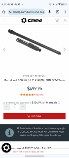

So I was just going to make a post about this. So question, how hard would it be to get someone to make a AR barrel for something like this ? Cmmg already has a kit for the regular 5.7 sooo..... Would just need a barrel in the .17 cal version... Sound alike some KAK might get into since they make the .17-5.56 already
