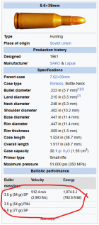

First it takes a .221 bullet instead of a .224. The 5.45x39 is on the same case as the 7.62x39. there are any number of wildcats and factory rounds based on that case from the 22 PPC to the 6.5 Grendel. I have a factory round that is loaded on a batch of brass intended for the 7.62x39. Headsptamped 711(might be cyrillic letters) over 61, semi-pointed soft point
The 5.45x39 has a smaller rim diameter than 7.62x39 and bigger than 5.56. Hornady supposedly makes brass for it, but have never seen any
That round was used for AK74 series. It has not been imported for sometime but as stated above Hornady does make it. Don’t know about any wildcats.

No, the story doesn't end, it doesn't start. There is more difference than just the rim diameter. We need to make this more clear.
A European 5.6x39 has a 7.62x39 as a parent, but that isn't related to 5.45x39.
5.6x39 = 220 Russian
5.45x39 does not.
There is no relationship between 5.45x39 and 220 Russian, thus zero chance of using a 5.45x39 to end up with a PPC.

Chronologically out of order.
First came the 7.63x39 (1943).
Then came the 220 Russian, from the 7.63x39, necked down.
PPC’s came after that, usually forming from 220 Russian.
5.45x39 was an unrelated 70’s Russian military development for the AK74, replacement for the AK47 that uses 7.62x39.
The 5.45x39 is very much an odd ball, with unique case head and diameter. Really makes no sense in the free world, as it is simply a Russian version of the 223 Rem.
As hinted to above, the “new” 22 ARC is essentially a standardized and modernized 22 PPC, which uses the 7.62x39 bolt head size (same as Grendel), which is now quite common in American rifles.
5.45x39 lives in its own communist world.
