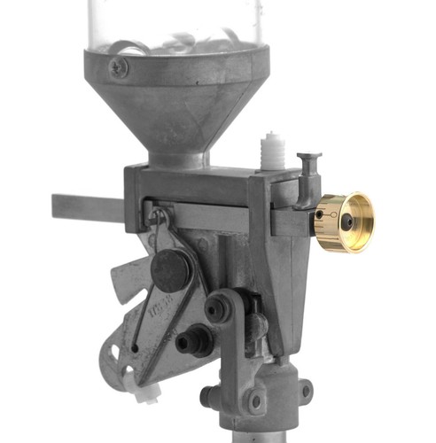

I put the Mr. Dial on my Dillon powder measures, and if I remember I write down the settings.
Well, I actually weigh each of my powders per 1 revolution of the dial to have as a reference.

How well does the dial work?
The dial is calibrated so you can count the revolutions, number, and hash mark divisions, whereas the Dillon just has a hex nut. I like them as I am not into a powder measure for each toolhead as I'd need a dozen powder measures. Besides that, I do not always use the same powder.
I made up a chart where I weighed the powder charge from 0 to 1, to 2 etc., so I'd have a quick reference.
If you are going to set up for one specific load with a dedicated powder measure than once, you have the powder bar adjusted for your powder charge you're all set, so the MRDial may not be necessary.
It is my understanding that Mike Dillon was flat out opposed to any knobs on the powder bar as people see the knob and are prone to turn them. This is also the reason most micrometer sights have coin slotted adjustment screws or are Fool Proof like the Williams.
