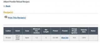

Everything has been fine with my 45 reloads until I tried to shoot the Blue Dot.
I will agree that more crimp is in order, the brass has been loaded many, many times, so we will be shooting some factory Remington up to get once fired brass.

I did take a box of the Blue Dot loads, increased the crimp, which might be a contributor to this problem. But when we were shooting New Years Eve, after shooting the first shot of the Blue Dot load a factory Remington round would not chamber.
