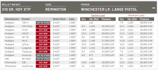

I’ve never had a 41 mag and now I do. Ruger super Blackhawk, I’m looking for loads. I realize the 41 rem mag isn’t the most popular kid on the block but a lot of pistol affecionados speak highly of it. I have the brass, the primers, the dies and quite a few pistol powders on hand but I’m hoping to get some input here. Bullets on hand are Hornady and Sierra 210s. If you have some info to share please do. Thanks!
It depends on what you want to do. High power loads use H110/296, IMR4227 or 2400. Mid range I like Unique and Hs6. Low power I like Titegroup and Be-86. Of these only H110/296 are powder you don't want to reduce the charge amount. I mostly shoot my own cast bullets 180 WC and 220 SWC with Titegroup around 4.5 - 6.0grs for easy target shooting. For me I like 14-16grs of 2400 if I want more Recoil. Of course start low and work up to where you want to be. $0.02

All of the above are a loaded with starting listed loads. I have several manuals to pull from plus the above info to compare. I’m waiting for more brass to load some bunny fart loads, I’ll use unique for those. I want to try some moderate loads with Hs6 too. I’ve had a crash course on the 41 mag, seems like it has a loyal fan base and deserves more attention than it gets. Thanks again for the input.
