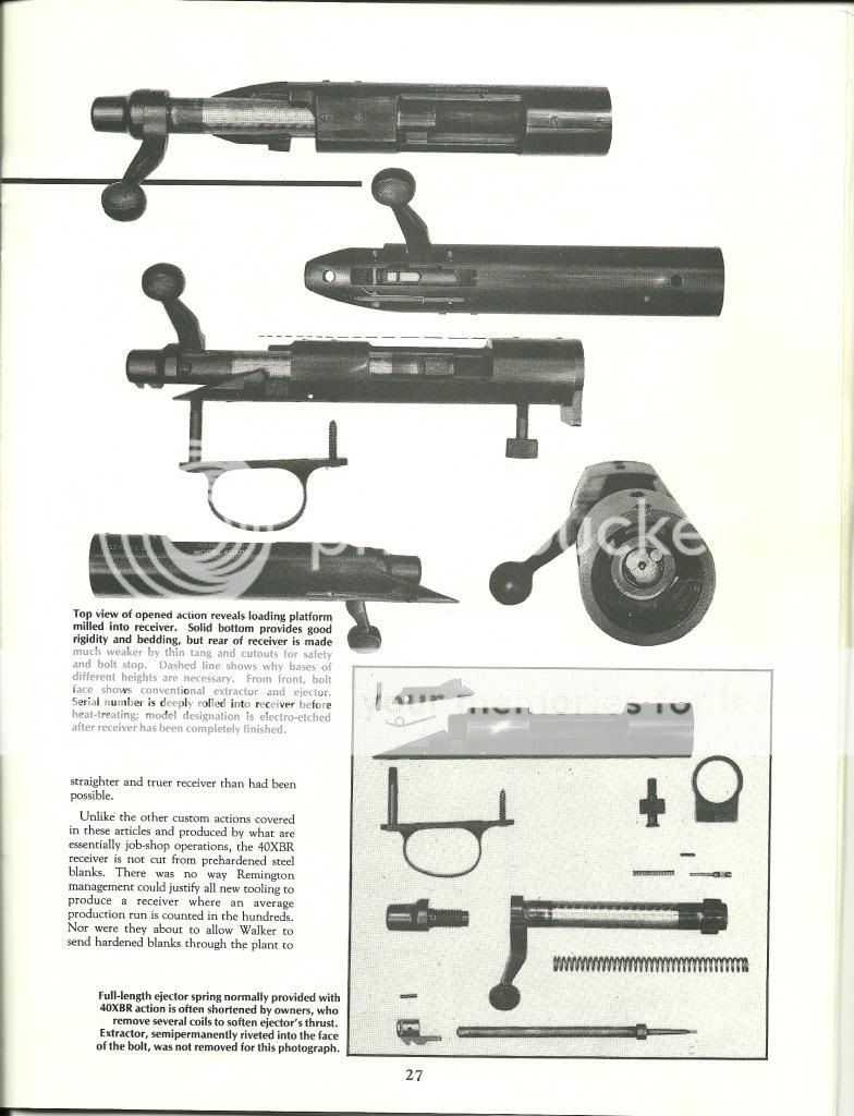

Does your action have stamped lettering or is it applied? The reason that I ask is that years ago I read an explanation (in an article in Precision Shooting) as to why the latter was done on the 40XB-BRs that might interest you. It has nothing to do with thread squareness, or bolt fit, but the story said that because it had been discovered that in the case of the most accurate calibers, in that model, that if the bottom half of the action was not a true cylinder, that accuracy was degraded. As a result, the largest action blanks that would fit the fixtures were picked for that model, and the order of operations was changed so that the ODs were ground after heat treating, and if they did not clean up on the bottom half, that they were rejected. Because stamping, heat treating, and then grinding would have required too much hand work to fix stamped lettering, a different method was chosen, which is what you see on these models. Back in the late 90s, after the move to the sun belt, I called the manager of the custom shop to see if that model was still being produce in the same way, and he had no idea as to what I was talking about, I think was done during the Walker era. I am also told that he did not have a very high opinion of the gas venting hole in the side of the front receiver ring, and that in some cases, for that model, they were omitted.

The lettering was not stamped into the metal on this action. JohnHenry sent me an artical about the XBR actions built when this rifle was done and these actions where processed a bit different and more care taken for these bench rest rifles that were produced during this time. The other 40X actions did not receive the same treatment. Does it make it better i have no clue. I do not know how long the XBR rifles have been offered.
