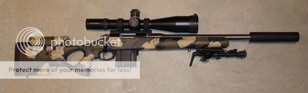

The shape of the 10-22 mag is too wide and requires a lot of the receiver to be removed.
These mags are compatible with all bottom metal that uses Accuracy International mags.
On the outside they look just like an AICS mag but have a 22 lr guts stuck inside.
I have received a bunch of PMs regarding the conversion and the mags.
My repeater started off as a single shot and jelrod1 did the conversion for me.
Lots of questions about mags. Themags are built around the external dimension of Accuracy International mags to they are comparable with any bottom metal that uses AI mags. I would guess they can be shortened to a 5 round mag and not stick out too far from the bottom of a standard BDL/ADL stock.
Here are some pics to hopefully answer some questions.

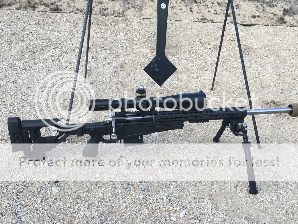

So Jonathan recently finished up my last two 40Xs. It was a bit chilly today but not a lot of wind.
This rifle was an absolute hammer before the conversion and it still is.
This one is a Lilja titebore also chambered with an EPS Match reamer. S&B 12-50 and an AI chassis. I am still using my Shark 308 suppressor just to keep the weight and feel the same as my AXMC in 243.

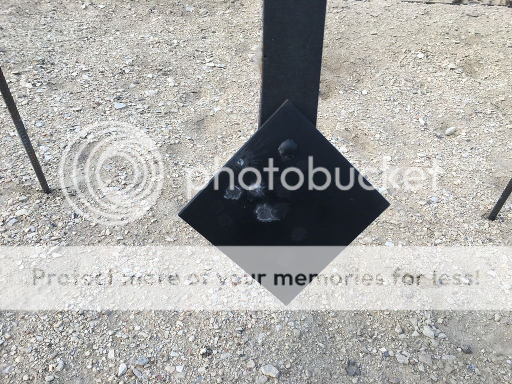

Below is five shots at 220 yards using a 2014 lot of Eley Match. The plate is 5 inches across the flats so thats about a 1.5 - 1.75 inch group, four being inside an inch or so.
