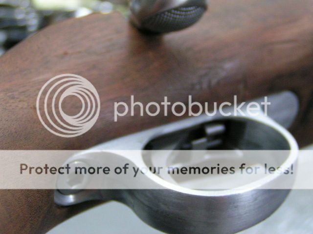

I also had on hand an early 722 era 40X RF stock from Numnuts. It's pretty beat up but still functional. I had previously modded a universal trigger guard I got from Numnuts and already had a ferrule and action screw for the front. Somewhere along the way the rear action screw got used in another project so today I received a Midway package with a correct length factory action screw for the rear. The Midway PN is 156089 for SS. The matching front screw is also the right length to work with the ferrule I made.

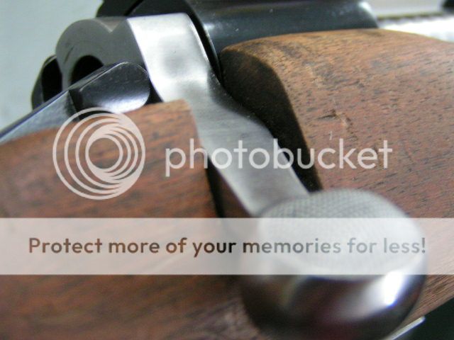

I opened up the bolt handle cut to fit the later bolt that matches the 223 bbl. The 221 FB tenon was cut to suit a PTG 2 piece bolt with SAKO extractor. This bolt has a straight bolt handle so the new bolt handle will work with either bolt.

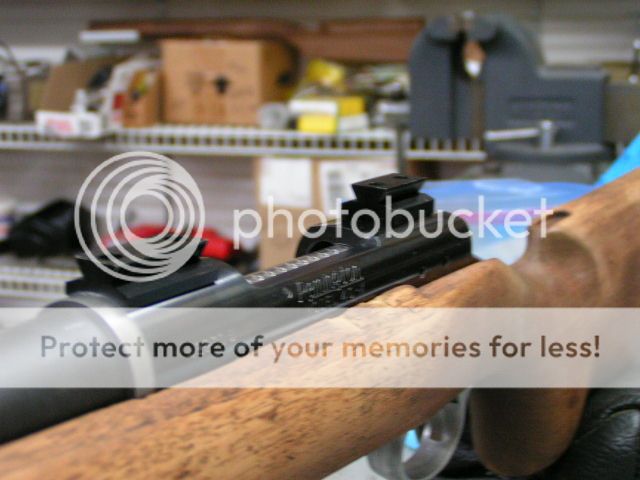

In the very first pic you can see that the ejection port is almost perfectly aligned with the cutout in the stock.
DSCF1171.JPG The ejection port 'rail' is lower than the half way point on a 700. The gas port hole is about half way on the front ring. The serial number should be just above the wood line. The ejection port rail can be used to judge "level", front of the action to rear of the action, but not for depth. You started with a RF stock. The ejection port isn't located the same on a RF action as a 700 CF action. I've been making wood stocks for 25+ yrs and some folks seem to think I know a bit about the subject, as they pay me quite well for my stockmaking 'skills'. Depth of a round action can be 'gauged' in the same manner that the pic shows the depth of a barrel channel being gauged.

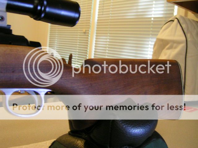

Here is the rifle with assembled for the first range trip. On this "final" assembly with the firing pin assy installed in the bolt I discovered that the slot in the top of the comb was not long enough to allow bolt installation. I have lowered the bedding surface a good bit and am not surprised at the problem. I took the stock back off and put it in the milling machine and moved the slot back. Then detailed the new cut and brushed in a coat of BLO.
This is only one coat of BLO but the stock looks pretty good imo. The blank has a blonde area along the top of the comb and along the lh side of the forend as seen in the pics.
