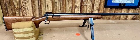

I just bought a Remington 40X 22LR
I wondered if someone can help me decipher the barrel code and serial number so i can figure when it was built
Photo of barrel code attached it looks like W O L B the serial number is 245XXB
It is also marked
US
22 LONG RIFLE It is a Heavy barrel / 700 action
I really appreciate help from the 40x experts
I plan on shooting it in a Vintage class we have local ( scoped) and then in an Open Sight Class we have at another local club
It looks like the factory trigger which checked at about 1 lb 3 oz and felt pretty decent

It sure looks factory but who knows you could be right on. I will try and get pic of the proofs on the other side.
Here are the proofs on the right side of the barrel
barrel is 25 5/16ths from the lug it is drilled and tapped for front sight blocks etc
It looks like it has been on there a long time--the bore shows plenty of age
Could it have been a Factory replacement?
Anybody have any ideas??
Thanks
It appears to be Remington. The REP or RFP (not sure) is a Remington Proof mark. At least one of the other marks is an inspection mark. The B at the end of the serial number usually means heavy barrel. The barrel could have been replaced but that too should be in the codes. Are there any other markings on the left side of the barrel such as a three letter or two letter code just forward of the receiver?
Assuming the WOLB means anything, I would ignore the LB as it seems poorly stamped. That would put it around 1994. But if it's a government gun or CMP it probably means little
Nothing else but what I have shown is stamped
