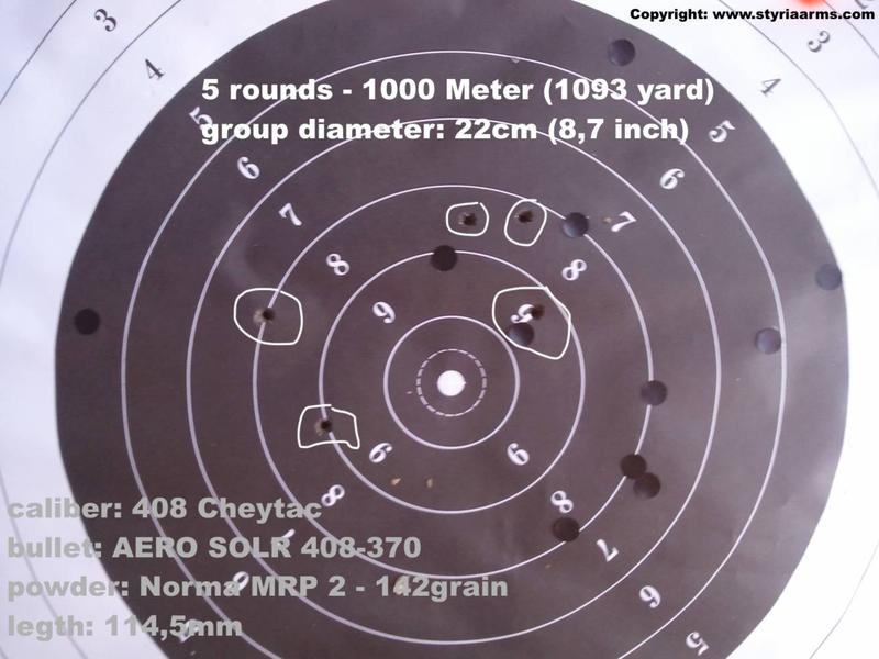

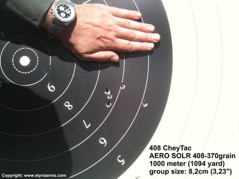

Here some great bullets from my workshop for the 408.
Very Very accurate.
Interessting: Copper is more accurate than brass.

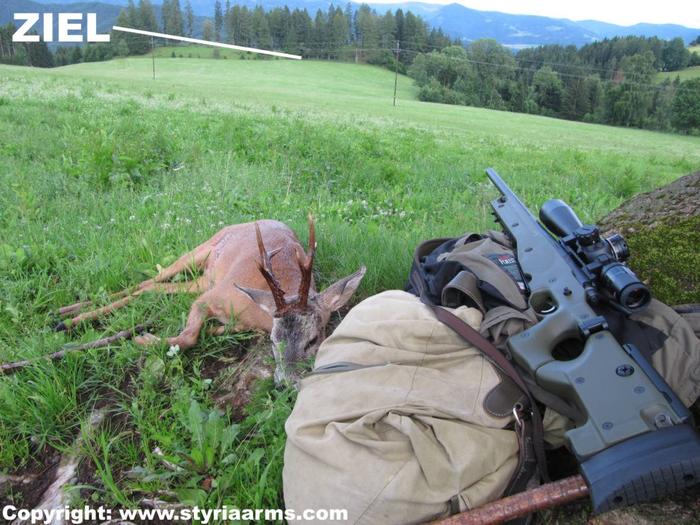

My company is placed in Austria and we have a lot of mountains and long range shooting is sometimes necessary ;)
Here a pic from a "short range" roebuck. Shoot with a custom AICS in 308 Win with my 115grain AERO copper bullet on a distance of 343 yard. That are standard hunting distances here in Austria.
With a 338 Lapua Mag or 408 its possible to shoot a little bit wider.

Impressive accuracy Herr Doktor... It beats any .50 caliber rifle I've ever tried. Have you considered the use of a sound suppressor just to check whether it tightens these groups a tad more?

The .50 can reach the same accuracy when it`s not made to CIP or Saami Specification !!! It`s a machine gun round and used as a sniper caliber it must get improved on some corners.
