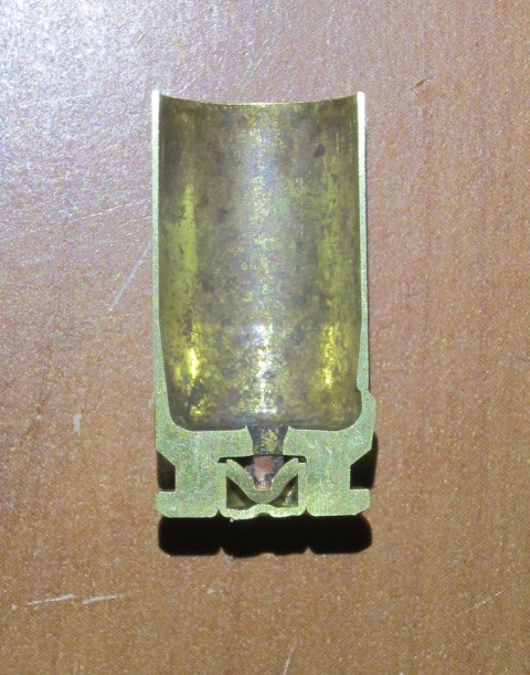

If the cases are bulged as bad as pictured below they should be thrown away. Using the bulge buster die on them will weaken the case and could cause a kaboom.
rimg.php
Below a case like above that was sized with the bulge buster, the bulge was over worked and the case cracked. And even if the case does not crack, if the same area of the case is fired over the feed ramp again it can let go and kaboom.
