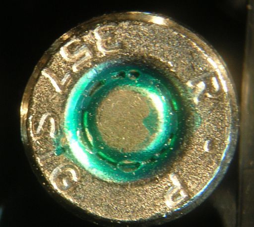

357 Sig Decaping Problems... Again!
Looks like wicking 29x series loctite to me. Try soaking in nitromethane/methanol fuel from an R/C hobby shop. Nitromethane will soften loctite right up.
I actually have some of that stuff Grocmax since I fly RC Jets & planes. I'll give it a try! Thanks for the idea.

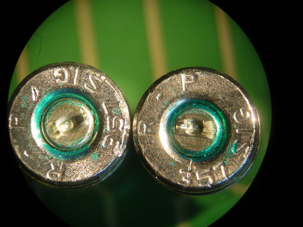

Just to let you know that the RC fuel worked! Here's a pic showing one with the green stuff and one after soaking in nitro.
We do quite a bit of bonding of metal parts with high strength high temp loctite, besides the official solvent from loctite ($$$$), nitro works real well, haven't found anything else that will touch it. The nitro will wick into the bonded joint and soften it up pretty quickly.

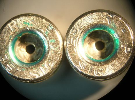

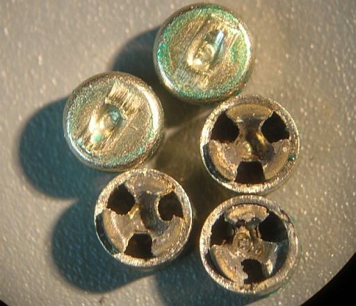

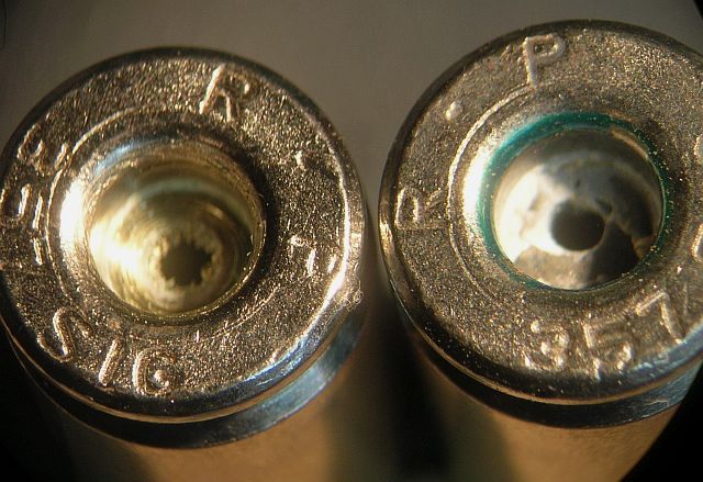

Back from the range today and I shot 5 rounds of the new Remington Saber Bonded ammo and brought back the cases for inspection.
Here are the pics showing everything. My suspicion is that the brass I bought had either been sitting out on the range in wet conditions or that when they cleaned them they sat for awhile wet IMO.
Unfired new ammo

Pockets after decapping. See how clean they are?
Primers from the 5 new rounds...Nice
And finally the ammo that I believe is the same cases I bought once fired.
