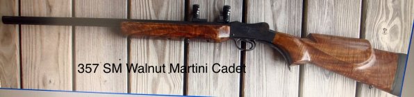

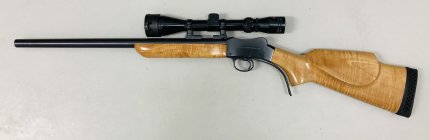

Steve Vogel Executive VP Ruger sent me two of the first SRM guns. I have owned SM guns since well before there was any ammunition, since, I have owned a few SMs including Contenders, BFs, Merrills, Martinis, Sevilles, El Daradoes, and a dozen 357 SM Dans made by Seth Wesson, also 445s and 3755s and these 3 custom guns, I built. including the revolver on a SM frame.

L is the walnut Martini 357 SM, M. is the Maple 357 SM Martini, R. is the DW SS 357 SM / 30 cal
