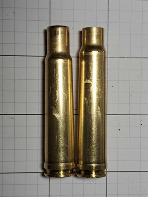

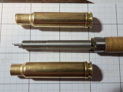

Well nothing is easy! Appears that forming the taper just pushes brass down. One of these cartridges is right at 2.05" for start of shoulder, the other is quite a bit deeper. Neither will chamber. Ughh. The diameter of case should be 0.480/0.485 but formed cartridges are 0.490-0.495 where the brass has moved. Bought a set of 375 H&H Mag to re-profile the case. Never thought it would be easy . . . .

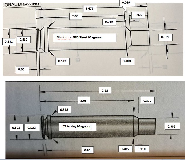

Making cartridges for this caliber "350 Mashburn Short magnum" is addressed in two books I have,
Parker O. Ackley "Handbook" (1962) and "Handloaders Manual" by Donnelly (2011). Seems straightforward. "Seems" is a word with many variations it seems!
Ackley
States on page 478 to use 300/375 H&H Cartridges necked down and shortened. Then goes on to say this is essentially the same as the "35 Ackley Magnum" and use that info for the Mashburn. Further info on page 475 for the 35 Ackley Magnum mentions forming, shortening and fire forming and lists several loads. Interesting but not terribly useful (except the loads!)
Donnelly
On page 263 there is dimensional drawing, load data (1) and case making info. Case making consists of using 300 H&H, expand the neck, trim the case, anneal the neck, and then the kicker - Full length Size in Mashburn Die! Check trim and chamfer the edges.
Me
Surely there is an easier way! I have borrowed "on approval" as set of 35 Ackley Magnum dies. The start of the shoulder is the same dimension for both Ackley and Mashburn - 2.05". I started with a nearly identical cartridge - the "358 Norma Magnum" which was not available "back in the day". It is also based on the 300/375 H&H cartridge and already has an upsized the neck! I bought 20 cases.
The Norma brass runs through the Ackley Die easily - but seems to be expanding the case diameter just below the shoulder/taper. Another issue is the length of the taper - Mashburn uses 0.06 and Ackley 0.11. I cannot tell for certain where things are getting hung up in the chamber - need to get my candle lit and do some soot testing!
My next plan (besides soot testing) is to get a 375 H&H die to reset the case diameter (and hope the neck and shoulder of the Mashburn Case passes through the die without issue! If that all works - push the start of the shoulder far enough toward the base that the bolt will close and then fireform

If the Cerrosafe numbers are right, the chamber shoulder diameter is about .009-.010  smaller than some of the dies you're thinking of using. What shoulder angle does the Cerrosafe show it to be?
I would take your Cerrosafe sample that you had casted, And measure it against what you have formed.
The 350 Ackley must have less case taper than the Mashburn.

I would take your Cerrosafe sample that you had casted, And measure it against what you have formed. The 350 Ackley must have less case taper than the Mashburn. Once you get fired cases you will be home free and can use the stuff you have gathered.
Thanks - It turns out it was not the cases or the dimensions - it was my brain not fully engaging! It was driving me nuts! Ultimately - I may not need the step to run the cases back through my new/used 375 H&H die to reset dimensions in the cartridge!
Story Follows: I had made two cases from 358 Norma magnum brass. The bolt would not even think about closing on, and both were "really close" to the chamber cast dimensions as well as the dimensions in Donnelly. One was "at" the shoulder length from the 35 Ackley die (same dimension - 2.05"), the other was pushed down far enough to get away from any shoulder/taper dimension problems. So I figured I had abused the cases enough that running them through a 375 H&H Magnum Die (without the expander) ought to sort out any dimensional indignities and allow me to sort of start over. Dies came in over the weekend and I did that this evening. All I really needed to do after that was trim cartridge length a few thou, and EVERYTHING was now at or below the numbers I had for the chamber!!
Still - ZERO Interest in the bolt closing. OUCH!!. Resisted the temptation to quit, get an adult beverage and watch sports for the rest of the evening and then put my engineer brain to work on it. I had taken a M1903 drill rifle completely apart for another project two years ago, like 99.9% apart. Great Fun - learned a lot!!. That meant I knew how all the pieces fit and worked together.
Step by step I went through the process of what could possibly be happening. Obstructions, misreading the micrometer, misreading the dimension diagrams, missing pieces, etc., no, no and NO. Finally - and I am apparently an idiot - realized it was the extractor that was not going over the rim and was just sitting there! No wonder it would not close!!
Took the two cases I had and placed them lovingly inside the extractor claw, and the one that was pushed down closed without any issue or annoyance. The one that is "at" the dimensions closed just fine with a little extra pressure the last little bit on the handle
I AM VERY HAPPY!
Now to create a third cartridge with what I think is the right process (with notes!), then a bit of fire-forming, and maybe - just maybe - make it happen!

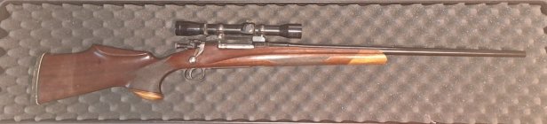

I hadn't thought of you possibly not knowing that the 1903 Springfield is just like a Mauser in that you need to feed it from the Magazine as it is also CRF.
Me neither! My M1903 experience is shaped by the guidance that the soldiers were using single shot until ordered to flip the lever to use the magazine. Well - great plan that did not carry over well to the great Sporterization and Wildcat experiments post war. I've learned something today - and that makes me quite happy!

350 Mashburn Short Magnum
Cartridge Creation (Work in Progress!)
McDonald 20-OCT-2025
Completed Steps as of 20-OCT-2025:
  • Find 358 Norma Brass, preferably NEW! Although the 350 Mashburn Short Magnum and many other similar magnums are similarly based off of 300 H&H and 375 H&H Magnum why not start with one that is REALLY CLOSE in dimensions to the final product?!
  • Use a 375 H&H Magnum Full-Length Die to Resize the Norma 358 Magnum brass after removing the Expander Assembly.
  • Use 35 Ackley Magnum die to set the shoulder dimension from the base of the case. Both cartridges have that distance as 2.05”! In my situation – the bottom of the 35 Ackley Magnum die had (unbeknownst to me) been cut off – which means you have to adjust the die downward until you get the start of a shoulder at the right place. As my die was “adjustable” with the base removed, I went with ~2.04” to allow some clearance with the shoulder angle at the neck.
  • Check case for function in the rifle. All three cases cycled through the rifle, having a firm but not “hard” closure needed on the bolt.
  • Case length came out at 2.53’, but needs to be 2.475. I left this alone for now as the excess brass may be pulled down if the Mashburn 30 Degree shoulder fire-forms properly.
Next Steps:
  • Do some fire-forming on these three cases with the “Cream of Wheat” technique. Sources vary somewhat in how many cycles of fire-forming are necessary – I figure at least two.
  • Trim cases to proper dimension of 2.475
  • Load the three cases with the lowest recommended power/pressure and test fire
  • If successful – do a bit of bore-sighting
  • Form the remaining 358 Norma Mag cases into 350 Mashburn Short Magnum cases.
