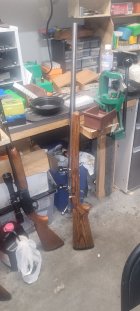

My rifle is on the way to the Smith getting rebored to a 1-14 twist chambered and throated for a 250g cast bullet.I've had 358 Winchester BR guns before but figured the 35 Rem will give me what I need.
it's a silly thing to do but life is short !
Having a dozen good 35 caliber rifle molds and already shooting a 35-40 Maynard in a custom single shot made it an easy decision.
Rifle is a later 77 Varmint with laminate stock.Barrel is 26"
