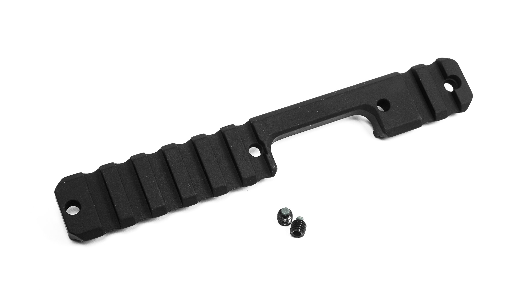

I purchased an Arken riflescope without doing my homework and realizing that the scope tube is 34mm.
I am trying to mount it on a rimfire rifle than only has a 11mm dovetail. The rifle is not drilled not tapped. I need something that I can mount to the rifle in 11mm dovetail. Then I'm thinking I can mount my 34mm rings to it.
I can't seem to be able to find anything.
What rifle? CZ 457 has an 11m dovetail, I believe. Area419 makes a great 457 pic rail
If a CZ, it could be either a 11mm or 3/8". I went down this road with DIP rails a few years ago. DIP tech guy at the time told me he has seen several CZ's that were 'supposed' to be one but were actually the other. Mine was one of them. I ordered according to their size chart, and it was wrong. They fixed the issue, but it was still a small hassle.
Scott
The rail COULD also be a 3/8ths. I'll measure it to make sure. But still my issue is finding 34mm rings that will fit the dovetail on the CZ 457 rifle.
Just looked at the EGW website. They have a base that I can clamp to the rail on the rifle so I am able to use my 34mm rings to mount my scope.
Reactions: MUP
That's the route to go. Makes it much more versatile and easier to mount scopes. Here is the DIP version on a 455 I had.
Reactions: MUP
Two CZ 457's here ,LH and RH,Nice to use MDT, area 419 type bases,they can be fixed to multiple scopes,slide em off one gun,slide scope on another.Mine are 15, 30 and 50moa,different bases can affect ejection on CZ's
The ones Harrells has is not a rimfire dovetail mount. They are a Davidson 3/8" base mount ring. They neither fit the groves on the rifle, or on a pic rail. Different animal.
Scott

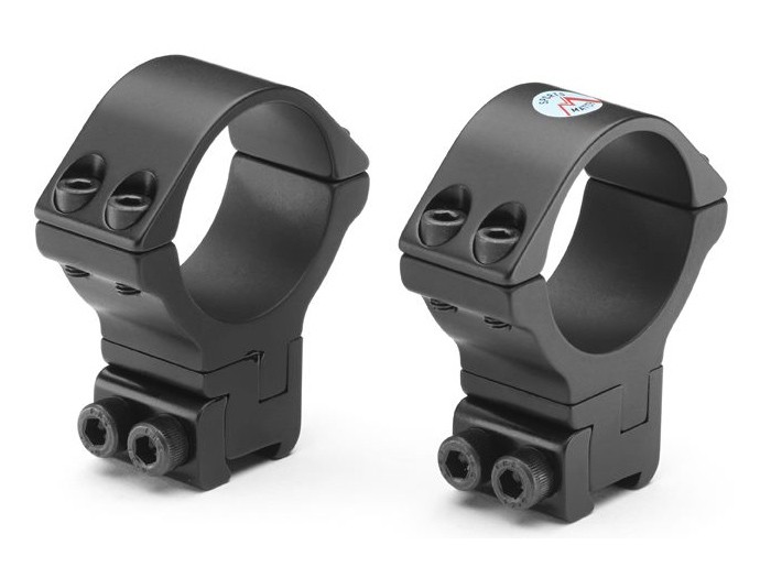

pyramyd AIR has a couple of styles (I found 2):
I got the sortsmatch. I have A March High Master and they are solid
