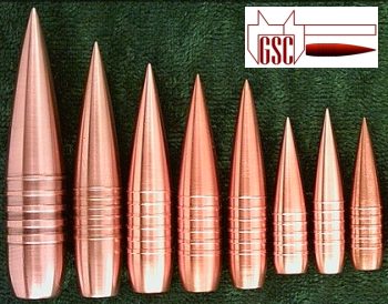

You may want to investigate the drive band bullets from South Africa. Impressive velocity gains have been observed with big, heavy bullets. The BC is also spectacular with these drive-band solids, produced by GSC:
Link for more info:
http://accurateshooter.wordpress.com/2007/11/28/drive-band-bullets-from-gs-custom-in-south-africa/
