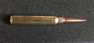

My last Edge:

Love the 338 edge but at 4.28 oal mine is a single feed
Wow, 4.28 OAL is longggg. You must be shooting some of those really long mono's or something because 4.28 with a 300 Berger or 300 Amax wouldn't leave a whole lot of bullet in the neck.

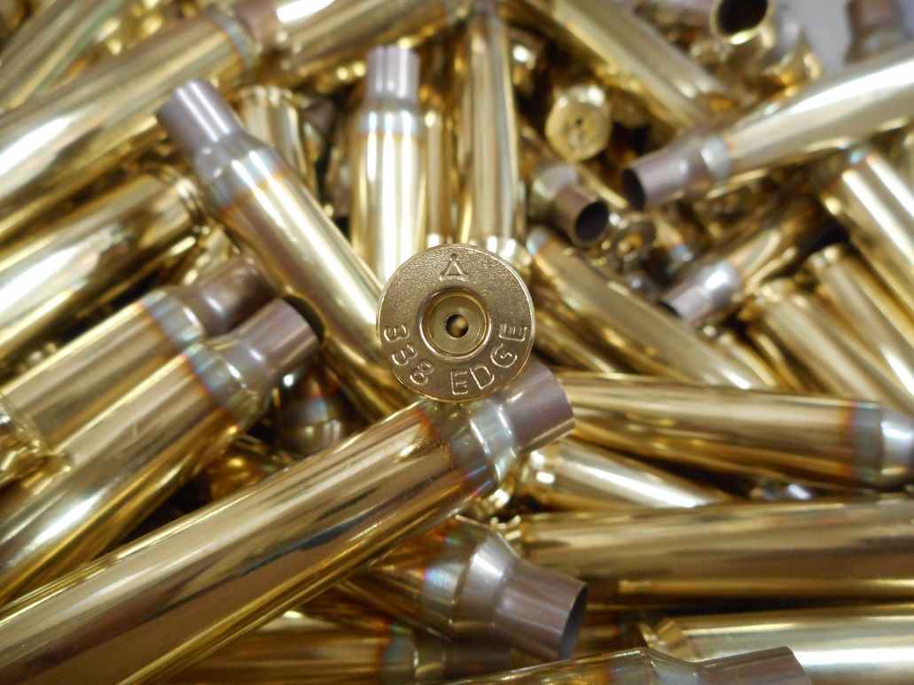

Brass used to be the weak link in the chain because the Remington stuff wasn't very good but since ADG started making 338 Edge brass it's kind of breathed new life in to the 338 Edge. I know Shawn has built a shit ton of Edge's and +P Edge's on Rem 700's with Wyatt's 4.0 mag box and runs them as a repeaters around 3.900 OAL. I think his +P Edge's w/300's aren't to far off of the 338 Lap Imp.

The ADG 338 edge brass is excellent

As was already mentioned, if you don't build a 338 Edge with the 4.0 mag box there's not really any advantage and you may as well go 338 RUM. ADG makes excellent brass for both the Edge and RUM so that's a huge bonus, for both, in my book.
