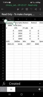

Frankie. To answer your question I was using a 23" 18TW Krieger with 118 EPS HBN coated bullets. With 35.8 I was averaging 3044. With 36.1 it was 3080. Like I said it was the first run of that powder. I bought 176 pounds of the stuff and I gave up on it because it never shot as well as N130 or H4198. I sold most of it to a bunch of guys from GA and SC. I would like to chrono the current LT30 to see if there is a big difference because I still have about 13 pounds of the 1st run stuff. Frankie. I'm still trying to recover from getting my ass handed to me at an IBS 2 day state shoot in Johnstown, NY. All 13 of us got beat at 200 yards by Scott Miller from NY with his 22 Miller. It's like a 22 Waldog. Man that thing was hooked up. I was 1st loser with a 250-6X but He shot 11X's with a dose of LT32 and some 52 grain bullets with a speed of 3550. He put up 1 more X at 200 yards than he did at 100. Go figure.
