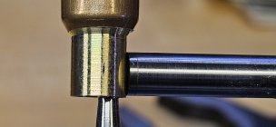

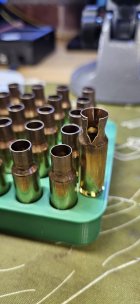

In my case I was neckturning Lapua 6br cases this weekend. I was surprised how many split using a PMA expander, when Peterson split zero.
Maybe it was a bad batch as quite a few fit the shell plates really poorly as well.

Yea sounds like maybe a bad batch of brass. Normally if one lubes the inside of the necks properly and runs the expander into the mouth slowly not very many cases are lost.
I've never seen a neck split like that. Albeit, I've only expanded maybe 300 pieces. Usually when necking up even with a single expander, I got one case that will be crushed into the shoulder. Just curious, what is your procedure?
I have only done Peterson brass. Like yourself I haven't done all that many.
PMA carbide 30BR neck up mandral. Liberal dose of Royal case lube.
Boy, did they squeal! :)
Wait, last question I promise. a 30BR carbide mandrel? PMA makes a "30cal from 6mm neck up mandrel." Which is what I have. Are you talking about that or a straight up 30cal carbide mandrel being used? I'm a big ole nothing in the shooting game, but if you used a straight 30cal carbide mandrel that may have been the issue.
Edit: this is what I use. Its got a long taper too it. https://www.pmatool.com/30cal-from-6mm-neck-up-mandrel/
Yes, were using the same mandrel.
