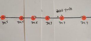

Also took @Dimner advice and made some straight lines.
So here's the results. Went back to the range with 34.5 and 34.7 and did my 100 yard test again. Then took it to 200. I definitely messed a shot up, and pulled it or something in one of them.
So I think I'll go with 34.7 and start playing with seating depth and neck tension. I'm not going back out until I have a better scope though.
Had some vertical on first group at 34.7 I'm attributing that to my gun handling skills.
200 yards with two charge weights. Pulled a shot or messed something up on one group 34.7

You are shooting good. Seriously consider doing a powder and seating matrix at 100 yards. You won’t be wasting time and you will learn a lot about your rifle and components. You will see distinct differences both good and bad that will help you identify the best combinations of powder and seating. From there, you can fine tune.
By doing the above, I have consistently been able to get to solid baseline tune in 50 rounds or less over multiple barrels. From there you can fine tune. Good luck to you.
