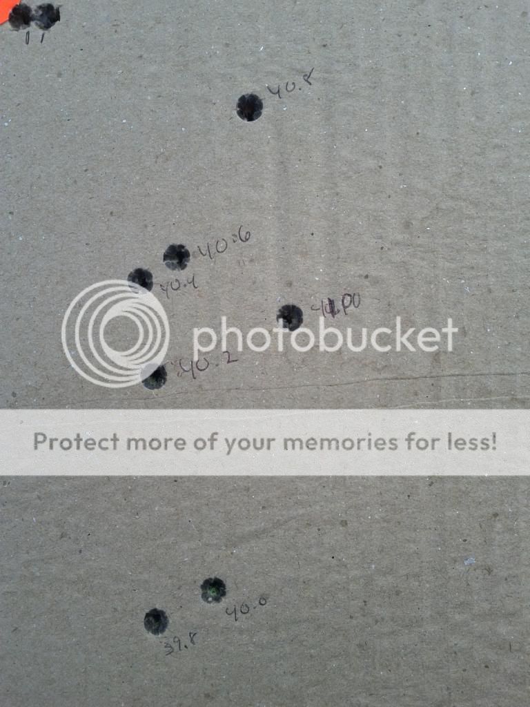

A quick pressure/ ladder test @ 200yds looked like this. this was with out touching the barrel tuner and it was a .10 jump on the 208. i dont know what happend to the 41.0 gr shot i am going to re shot it agian, since i had no pressure signs what so ever. Ill be going up to 42gr in .2 increments
UPDATE to the thread
i ended up with 41gr of IMR4064, jamming .10 (2.980 COAL) into lands it took me 40MOA to get to 1K. So JBM says 2400fps is where i am at but the accuracy is .3 @ 100yards for 5 rounds. so even tho i didn't get to 2500FPS i am happy with accuracy and consistency at 1k i shot a 180-3x on my last relay of the match. i need to read the wind alot better as i learned.
