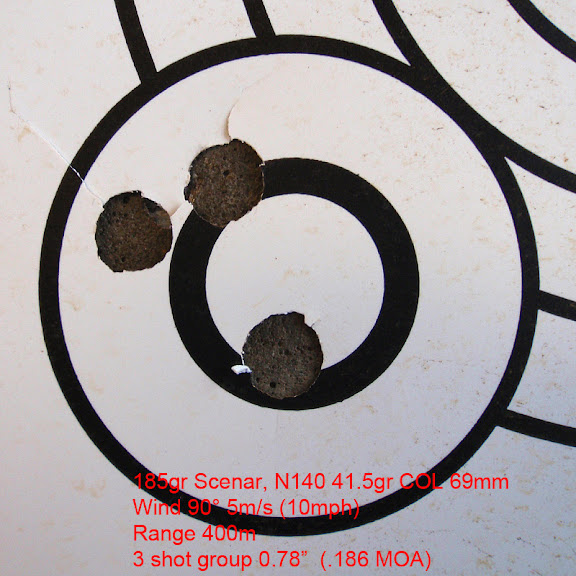

at the range yesterday I tried a new load, 41.5gr N-140 behind the 185gr Scenar and I got .78" 3 shot group at 400m. I think that's pretty good for a long range beginner...
Nice 3 shot group. If you can get the same groups with 15 to 20 shots. You will never lose a F/class match. You will also hold every record there is
I might get it with 5 shot, but 20 shots take a lot of time and here in Iceland I might get at least 4 different wind direction, snow, rain, sunshine and even a hail storm in that time... plus the temp could rise and fall 15°C
so I think 20 shots under 1" at 400m is not going to happen...
