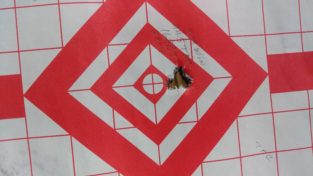

I tried some that I had laying around in my .308 for some of the Berger 185 Jugs. Using 45.8 grs I got 2618 fps out of my 26" Krieger barrel at 68°F. That was my best load for this powder where I got a .456 MOA group with an SD of 4.2 and ES of 6 fps. I was hoping for a tighter group with that and going into a AZ summer, I'll not be using this powder given that it's very temperature sensitive. Maybe I'll revisit it again when the mild climate of AZ returns this winter. :)

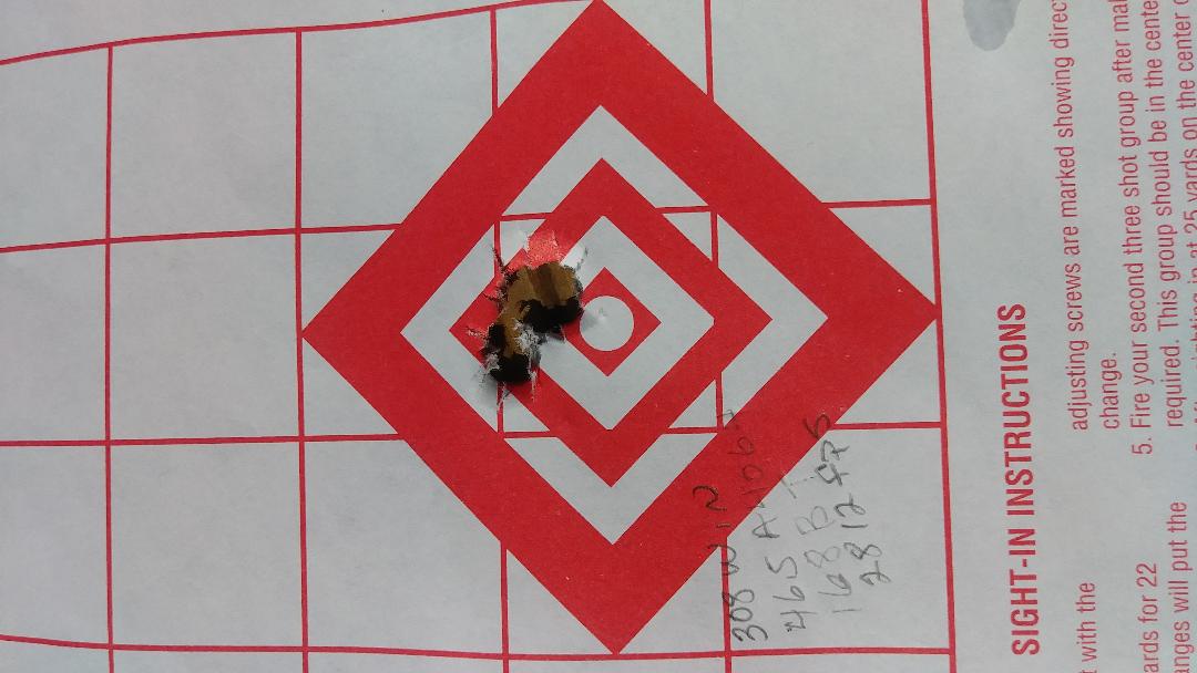

do not know why nobody ever mentions accurate 2520 powder. there is not a 308 I ever loaded with it that did not give excellent results. before it was widely known it was called the camp perry powder it had won so many matches there
