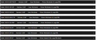

I have looked at this site for .308, 180gr load data -- I'm just unsure which of the listed bullets there is a good match (if any?) to the two types of bullets I have.
The only bullet that lists BL-C(2) or CFE223 load data is the "180 GR. SPR SP" but I don't know how that compares to the bullets I have on hand.
