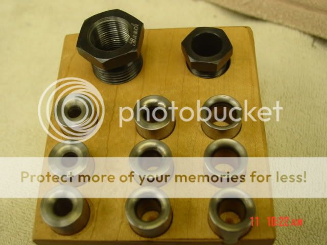

Here is the form die I use now... from Butch
Thanks Kodiak for the information, I'll follow up with Butch. I don't mind spending a little time for good brass. Just neck sized some 7X57 Norma for my 6mm AI and turned all those necks also. I guess I'll keep the Lapua brass. Rick
Rick, I am making 6.5 Creedmoor brass out of new 308 brass by doing what Kodiak said. I had an old 308 bushing die and cut 1/8" off the bottom of it and then used it with a 7mm busing to push the shoulders back. I then used my Dillon power trimmer to cut them down as far as possible then ran them into the 6.5 creedmoor die. I then turn the necks down to about .014 and have a really nice looking case. It will work for the 6XC too because I used my 6XC die to try one to see if it would work and it does.

If you have a reamer for the 6 XC and a lathe take some 7/8 round stock and thread 7/8 x 14 TPI on it and drill a pilot hole that will take the pilot of the reamer. Once you enough depth reamed to support the shoulder stop reaming and drill the neck out. Once you start threading do not take the piece out of the chuck until done. You do this a number of times so you can push the shoulder back in stages starting with the largest diameter throat and step down. As long as you are not doing 1,000's of brass hardening is not required.
This is not nearly as elegant as Butch's system but it works and can be made up in a little time at the lathe.
