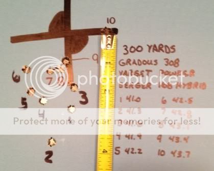

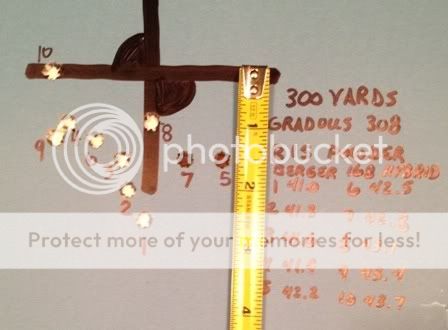

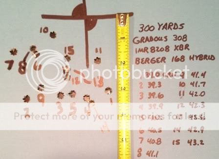

Here are pictures of 3 ladder tests that I shot today at 300 yards using a front rest and a rolled up sweatshirt as a rear bag (not smart enough to bring all my gear to the range)
The Varget and R15 are easy for me to read - good node up to shot 9 then big jump at shot 10.
The IMR8208 is harder - 6,7,8 good group. 11-15 good except 14, which is VERY bad, maybe I messed that shot up?

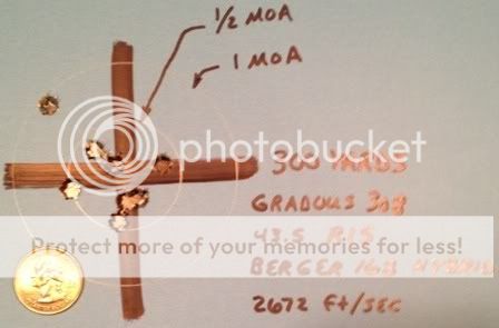

This is a group that I shot with a guesstimate that I loaded prior to the ladder tests.
I should have stopped after the 7th shot.

Looks like you have a good node as well with the Varget powder there.. between 43.0 - 43.5 grains. That 43.5 grs of RL15 is looking very promising as well. That load is looking like it is about 130 fps above transonic stage at 1K. At least here where I am at.
My understanding is that the entire hybrid line of Berger bullets is very forgiving regarding seating depth.
6-8 with both Varget and 8208 look to be the least vertical 3 shot group.
Isn't that moving somewhat slow for the 168gr bullet? I am getting right over 2700 with a 178 gr bullet out of a 26" barrel
I think 2672 is decent for a 24" barrel.
I prefer to find an accurate load that is on the safe side rather than push the load to get a few extra feet/sec. Where I shoot is limited to 600 yards, so there's no real upside for me in eeking out the max speed since I don't have to worry about stability at 1000 yards.
