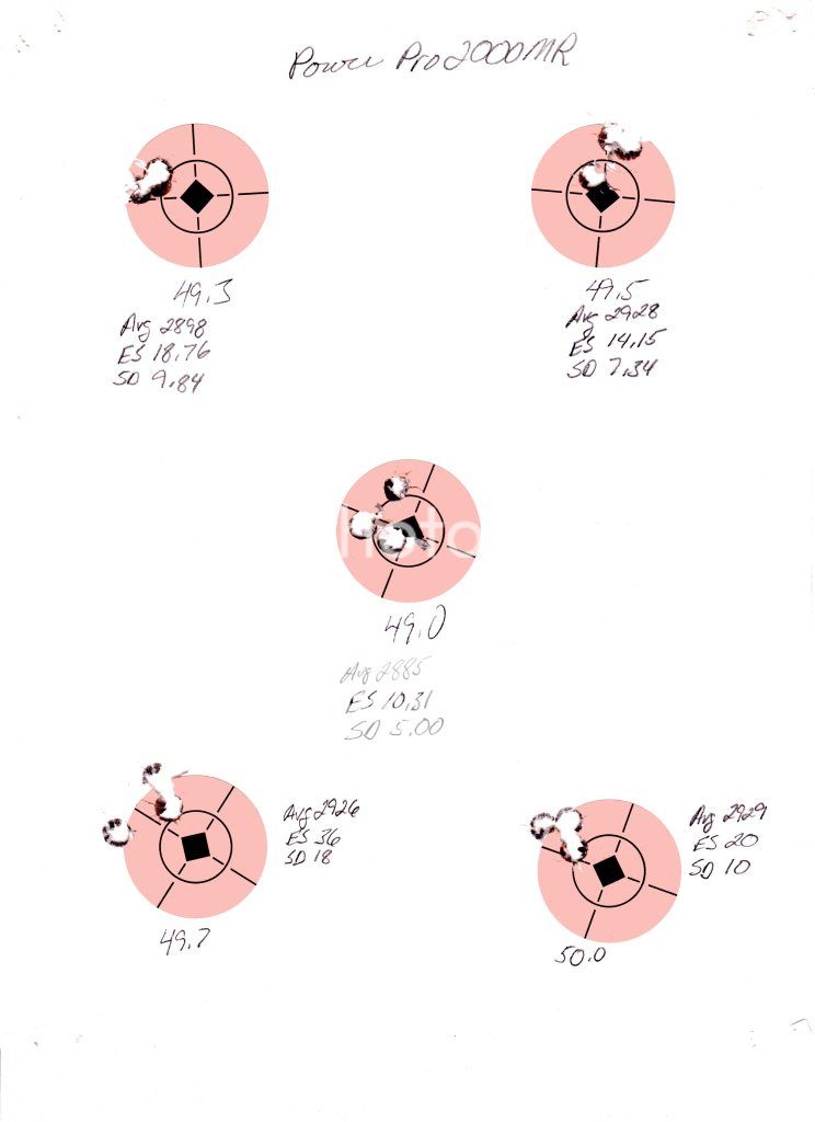

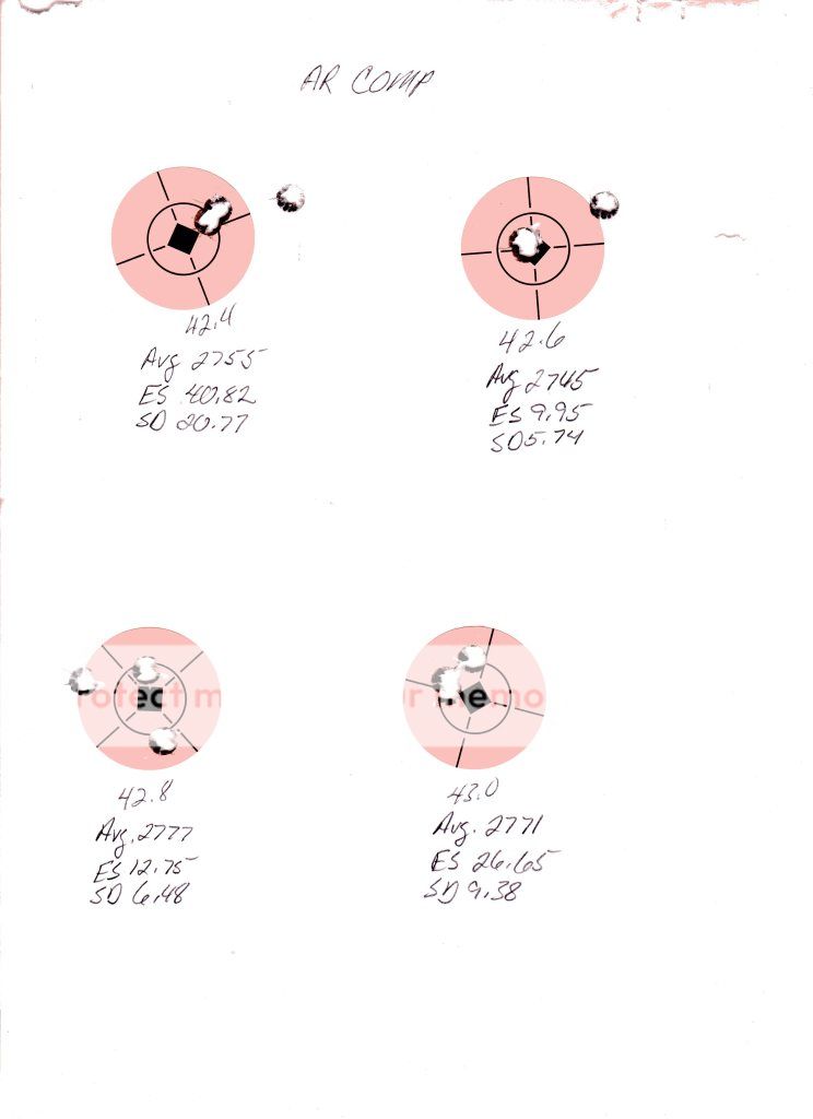

Well I finally took the plunge into a new bullet. I've been debating this bullet to use for F-T/R class this year. As this is my first year, the only thing I have to worry about is winning (don't see that happening, my wind skills SUCK! ). Anyway, I was able to get to the range today with some bullets and 4 different powders. The idea for 1000yd competition is that I need to meet a specific number. So that number is Mach 1.2 at 1000yds. To do so, many choose to shoot the 175 SMK, Berger, 178 A-max, and 185 Berger. These can do it with nominal velocity around 2600-2700 fps depending on the bullet. Some will even use the 208 A-max and the 210 Berger. These are all in .308 Winchester. I have to use .223 or .308. They are the only permitted calibers for F-T/R.
So I know that my rifle loves 168 grain bullets. Berger came out with a magic pill that cures the low BC disease that plagues the 168 class bullet. It is the Hybrid w/ a G1 BC of .519 and G7 of .266. If you crunch the numbers, the 168 Hybrid only needs to be pushed to 2740fps to achieve the magical number of Mach 1.2 to achieve the minimum stability speed for accuracy at 1000yds. Well after much research and debate I have found some powders that will do just what I need. With out further ado here's what I got.

AR Comp
42.6grns 2748, 2748, 2738 Avg. 2745 ES 9.95 SD 5.74 Group 2 in one hole with a flier. I think if I seat them another .005 to .010 deeper, I should be able to rain that in.
42.8grns 2785, 2777, 2771 Avg. 2777 ES 12.75 SD 6.48 Same as above.
Power Pro 2000MR
49.0grns 2886, 2890, 2880 Avg. 2885 ES 10.31 SD 5.00 Group .5”
49.3grns 2890, 2895, 2909 Avg. 2898 ES 18.76 SD 9.84 Group .2”
49.5grns 2919, 2930, 2933 Avg. 2928 ES 14.15 SD 7.34 Group .5”

So I am going to try these loads at 6 or 700 yards to see how they perform at distance. I have high hopes for the PP2K 49.5, RL17 49.0, and 42.6 of the AR Comp.

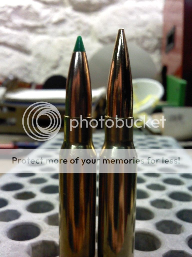

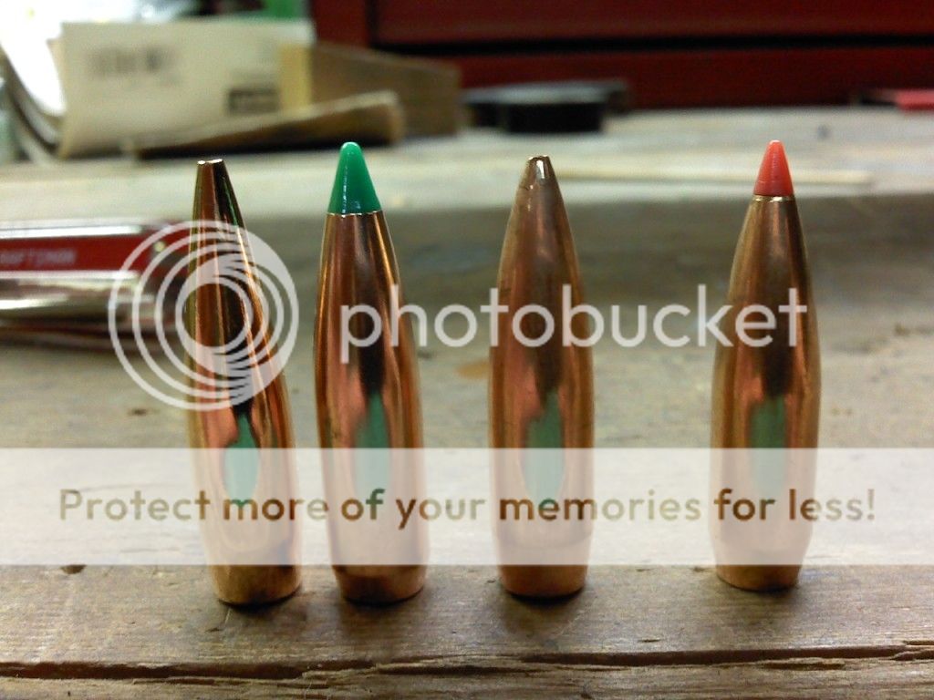

Here's a comparison: (left to right) 168 Berger Hybrid, 168NBT, 175 Custom Comp, 168 A-max
You can see that the Berger has a much smaller bearing surface with a longer nose and boat tail.
Seating depth with 2 separate accuracy loads.

Here are the targets from Wednesday at the range. Not sure what I did with the RL17 target. It was in the .2" or less range. It's stats were:
Avg. 2777, ES 5.73, SD 3.00
I think I can take care of that flier and tighten up the groups in the 42.6 and 42.8 seating the bullet a little deeper. That should also tighten up the ES too.... theoretically! ???
100 yards is mostly a marksmanship test of your abilities to control your rifle. You might want to run that test at 300 yards. I think you'll get better feedback. Shoot 5 shot groups (with the same point of aim as you are looking for vertical dispersion) and narrow them down to to 2 or 3 loads. Once there, do a round robin style of firing to tighten your results (vertical) with slight adjustments to your load. ES/SD for 3 shot groups is ambiguous. Once you have your load, shoot 10 shot groups to get an idea where your ES/SD is if that is really important to you. Seating depth variations will tighten these numbers. Your one target group is marked RL15. Did you mean RL17? RL17 has a reputation of throwing flyers.
Do you really need to push those bullets so hard? Seems excessive and a bunch of barrel burning in a .308. The .308 is easy to load for and is very forgiving. Your rifle seems like 2730-2750 fps. Just pick a load and velocity with minimal fuss and go win some matches. Personally, I like the 185 LRBT powdered up with Varget although I am going to see how H4895 does. Don't get too hung up on the Mach 1.2 thing. Yes, it is a factor, but you really need to just go and shoot and see what you have going on at the target and 1000 yards.
