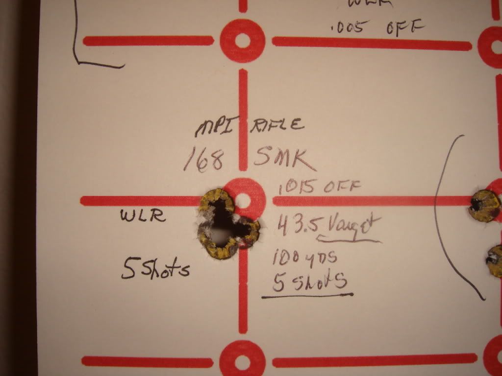

Phil, I can send you several target pictures of my 308's. All are within 1/2 MOA. Just do your part. The factory barrel is definitely worth giving a try. I have had several that shot the same with factory barrels. Any good factory round should do the job. I have tested about all of them, and the $22 box ammo shot just as good as the expensive ammo.
[/URL][/img]
