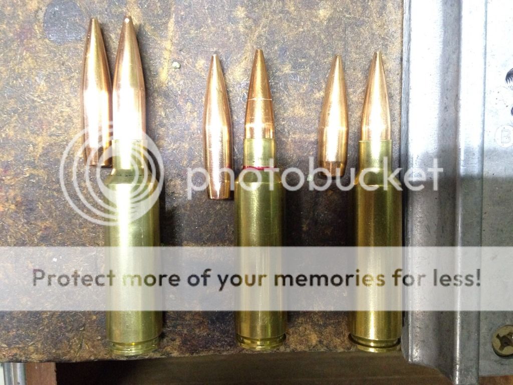

I'm having a 300wsm done and my smith and I forgot to discuss the freebore on the reamer to be used. I have a barrel now that puts a 210 berger at 2.967" base to tip; 2.280" base to ogive. I have no idea the throat on this one. This barrel will work for hunting since it can be mag fed just fine and can handle as light as 155 vlds.
I have a guy that base to tip is 3.270 with a .205" freebore. My smith chambered my new barrel with a .230" and that, according to the member with the .205, would put me at 3.295". There is barely any bearing surface in the neck. Is this right?

Left is extrapolated from a member on here. It would be .230" freebore with a 210vld. Middle is my current barrel with a 210 and right is current barrel with with 155vld.
Doing the math backwards, I would have to have a negative freebore to be back from the .230" extrapolation. (I know there is no negative freebore)
Look at Alex Wheelers video on how to find the lands. A 230 freebore would not put the bullet as deep in the case as you show in picture 2. Matt
