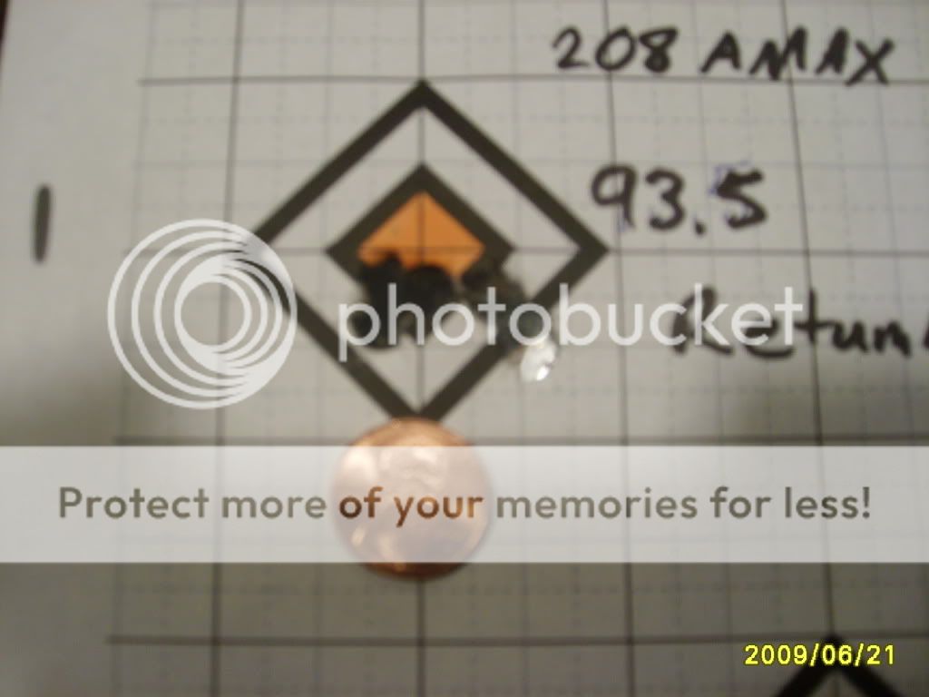

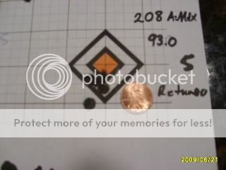

Well i have been wondering about the 208 A-MAX & retumbo for the 300RUM since i heard hornady came out with the 208, but haven't heard much about them for the RUM nor could i find any data for this combo, and ive asked everywhere to no avail, so i finally bit the bullet so to speak, and ordered a 100 of them, and going off old loads ive used for 210 bergers i loaded 50 rounds in 5 round 1/2 grain bumps starting at 89.5 retumbo ending w/ 94.0 grabbed the gun and went to the spot i can shoot closest to my house, but can only get out to 175yds, started off w/ 89.5 and was not impressed, until i hit 93.0 and found the sweet spot, i think i found my new combo, these groups were not shot from a bench, or even a sand bag, but off of a folded blanket on the hood of the truck at 175yds, now i don't shoot for score nor do i even know how to properly measure a group, maybe someone here can tell me what these groups would score, i shoot longrange out to 1000yds about once a week, but not for group i like to shoot plastic containers filled with colored water, it's just way more fun for me than punching holes in paper,
these are the 93.0 & 93.5 groups at 175yds, i hope this helps someone looking for the same load i was looking for..
