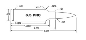

I’ve always liked the design of the 300 Ruger Compact Magnum (RCM). It’s one of those cartridges that never had a chance to shine due to its restrictions of a 2.8” COAL to fit in standard short action rifles which also had short velocity robbing 20” barrels. At a 2.8” COAL, the big 30 cal bullets were seated so deeply it annihilated the case capacity and any power left over was diminished with the short barrels of the rifles it was chambered in. It never had a snowball’s chance in hell to generate any impressive velocities with the way it was originally designed. So just like the 6.5 Remington Magnum many decades before the RCM, it became all but obsolete nearly as fast as it was introduced.
With the RCM having a case length of 2.1”, a base diameter of .532”, a shoulder diameter of .515”, and a neck length of .305”, it has the bones to be an impressive round with the proper freebore to seat heavy bullets out further in a XM length action or long action. It’s a fair amount larger than the 6.5 PRC case. In my mind, the 6.5 PRC should have been based off of the RCM case design. It would have been much more impressive in the short magnum 6.5 niche. Pics posted below showing the difference in case dimensions between the 6.5 PRC and 300 RCM.
If a person was to improve the shoulder on the RCM to 40 degrees and design a reamer to maximize case capacity using adequate freebore, I think you would see an entirely different set of animals with various neck diameters on the RCM case.
Problem is of course that there is no high quality brass available for the 300 RCM since the round died off so quickly. For that reason it will most likely stay where it lays.

Yeah I wouldn’t do the RCM for the same reason. Just pointing out that it’s is a very ideal design for a XM length action. If ADG or Lapua ever picked up the RCM brass, I would start wildcatting on it in a heartbeat
Now that Lapua is coming out with 300 PRC brass, don't count it out
ADG, which is just as good as Lapua, already makes 300 PRC brass. Problem is the 300 PRC is a lot longer case than the 300 RCM. The rim face to the shoulder junction on the 300 PRC is 2.121” which longer than the overall case length of the 300 RCM. Overall case length of the 300 PRC is 2.580”
You could painstakingly shorten a 300 PRC case to form 300 RCM but then you would have thick body brass up in the neck area. Not something I would try or recommend. Then with 6.5 PRC brass being about .070” too short, that leaves the RCM left in the middle without much hope for any future.
Funny thing is that Hornady worked with Ruger to design the 375 Ruger, the parent case of the 300 PRC, then Hornady also had a collaborated with Ruger to design the 300 RCM which is also based on a shortened 375 Ruger case.
After years of little success with the 375 Ruger and 300 RCM rounds commercially, Hornady necked down the 375 Ruger to make the 300 PRC (which had already been done by wildcatters) and they brought life to a new round. Then shortening the 300PRC/375 Ruger to make the 6.5 PRC they birthed another popular round. But they never went back to the middle ground on the RCM design.
