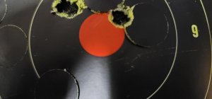

I have yet to find a box of Hornady , or any brand for that matter shooting groups like that without some sort of issue aside from the ammo. The 212ELD-X Hunter in 300PRC shoots so well in my Bergara that the best I could do by handloading is to try and replicate it.. get a box of that stuff and see if it works any better for you, use it to work that out and fireform some brass in the process.
Picture is of the ELD-X Hunter box ammo @100 yards. W/Bergara Premiere HMR Pro. Harris Bipod. Winter conditions sighting in a NX8. Left Impact is 3 shots, right is another 3 shots group after scope adjustment.. give that stuff a try.300.jpg
