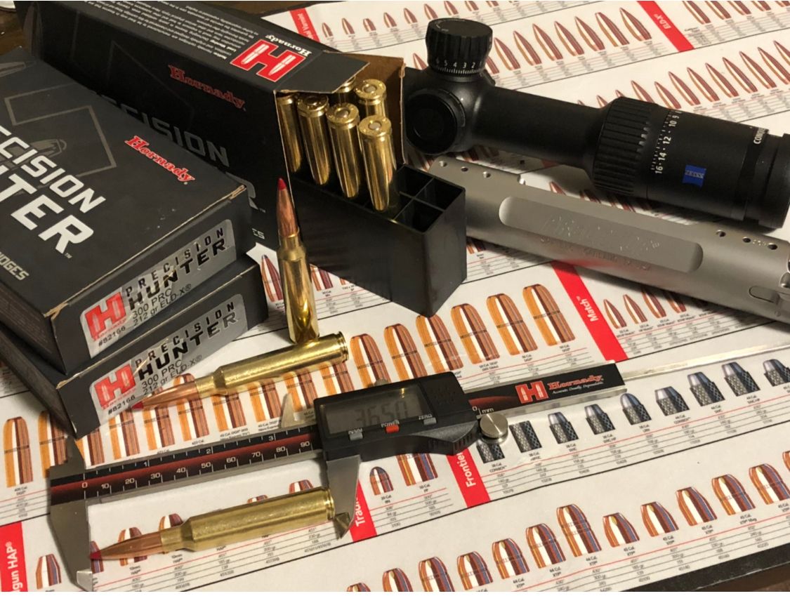

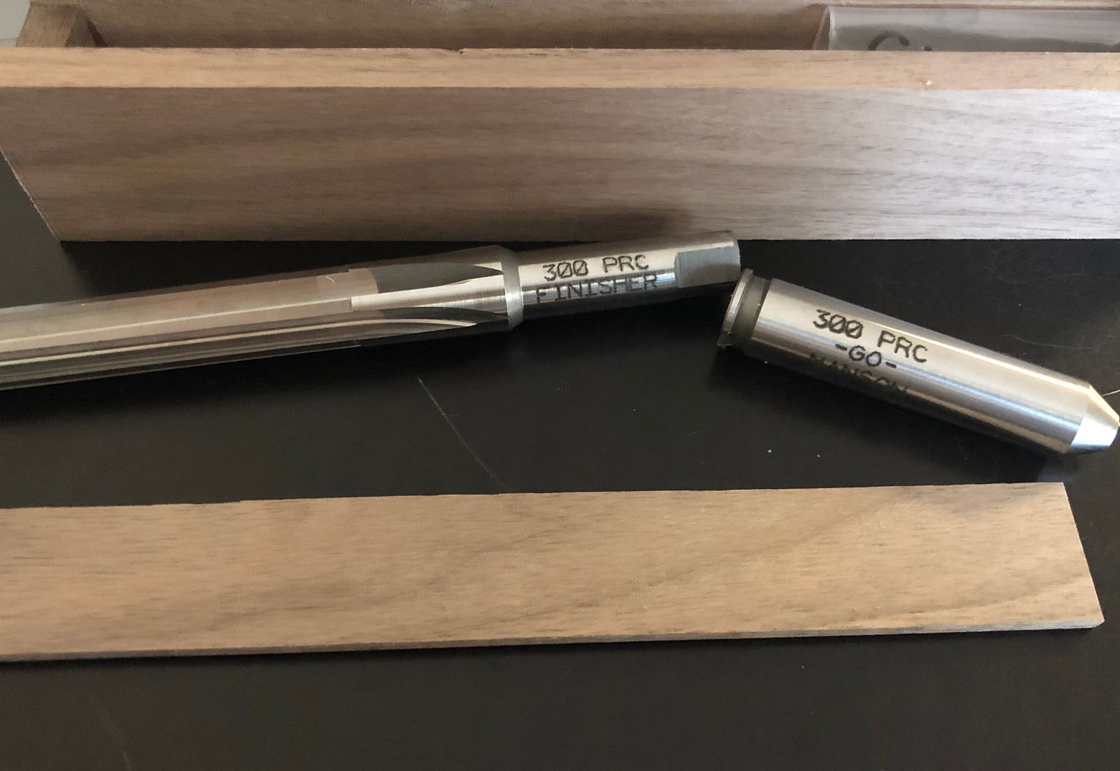

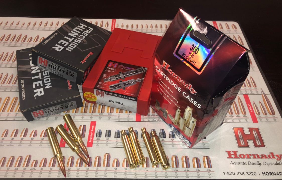

I'm just collecting the parts for my 300 PRC build and and can't wait to have it all together,I just received my Manson Reamer, Hornady ammo and Brass, build as follows,
Stiller Predator Action
Barrel TBD- a 26"#3 Fluted 1-9.5 twist some sort
Timney Calvin Elite Trigger 2.5lbs
Wyatts Mag Box
Stainless bottom metal
Wildcat Composite stock with palm swell fitted tony right hand, high comb and cheekpiece
Custom hand made brake.
topped with Talleys a Zeiss V4 4-16x44 Z-Plex
will be built by Gary Flach

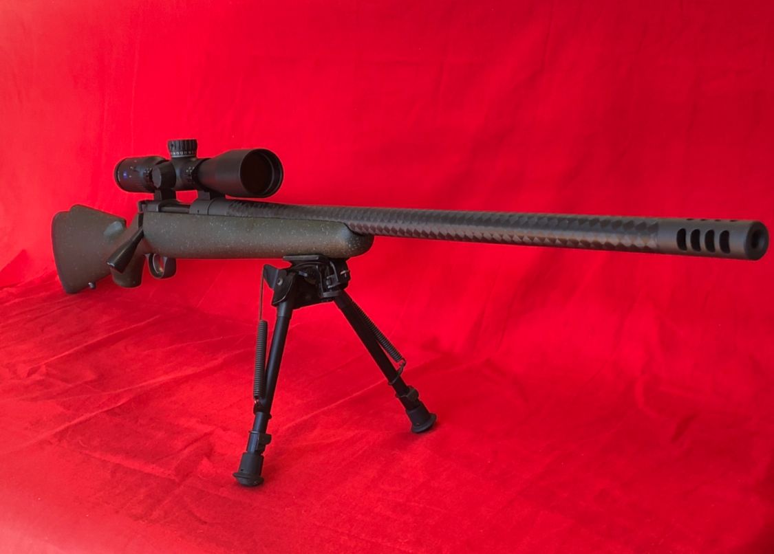

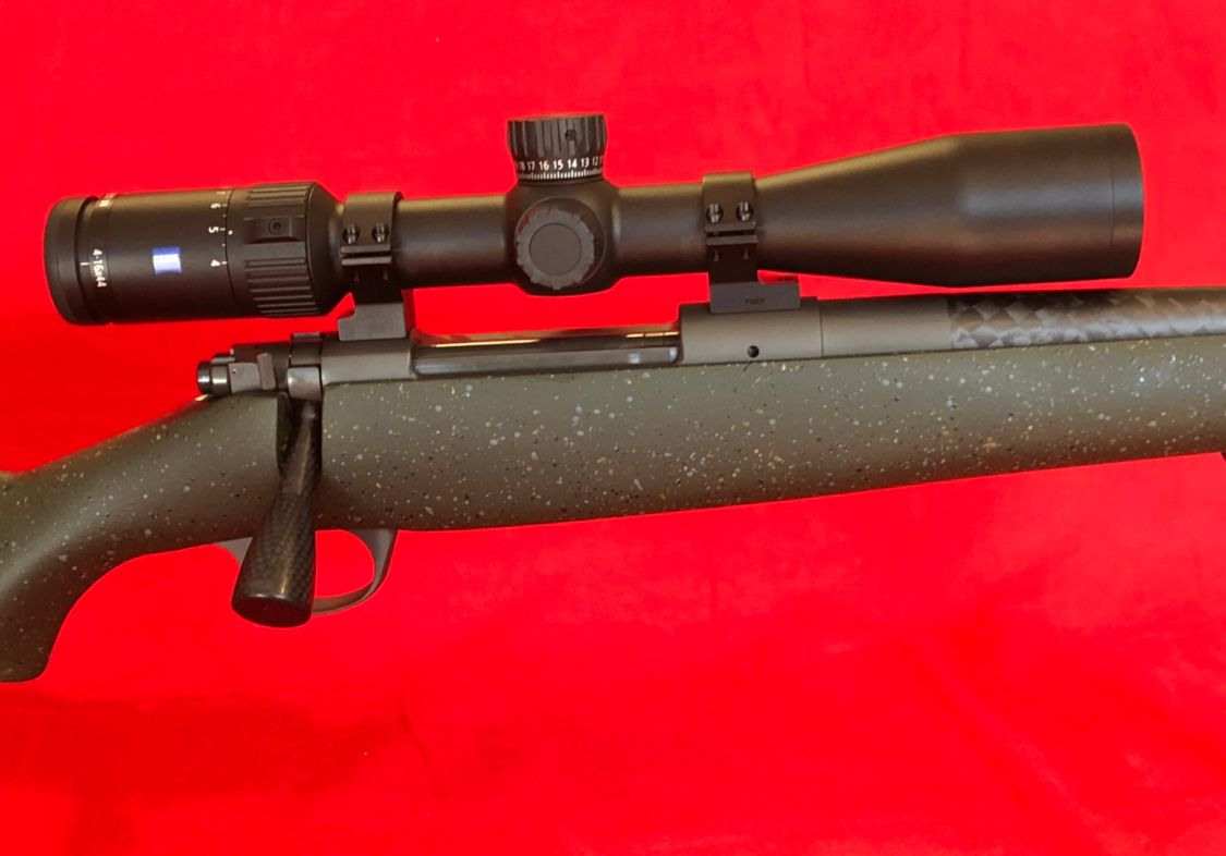

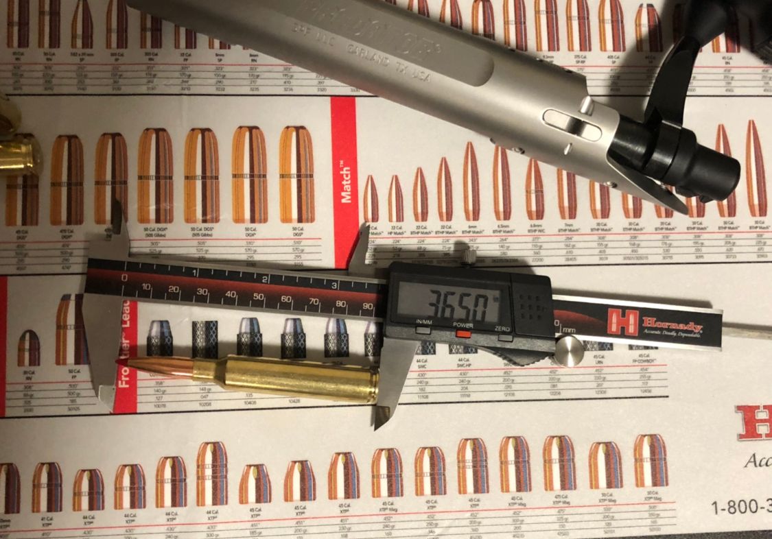

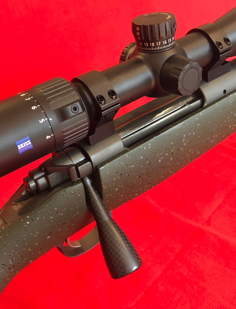

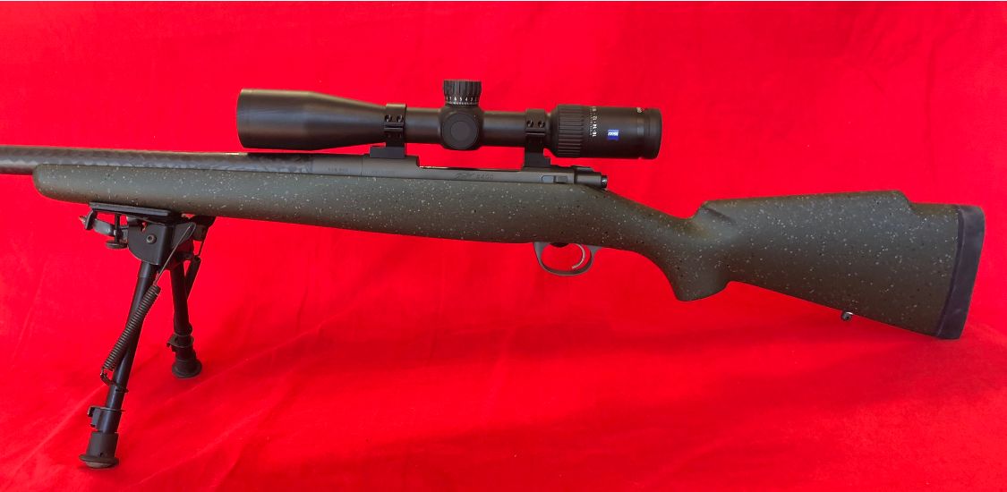

Ok the #4 barrel for my 300 PRC Stiller action build hasn't shown up yet.................so I had a Kimber Montana 8400 300 win mag donor laying around and a 26" Hells canyon Carbon Fibre 1-9.5 twist barrel so my gunsmith suggested we put a 300 PRC together with that action,
He lengthened the mag box to 3.7” and opened the bottom of the action up a tiny bit, hand made one of his special brakes, trued and squared the action, lightened the trigger, some pewter gunkote, added palm swell and high comb on the Montana stock and a cool paint job as well as a carbon Fibre Bolt handle, Talleys and a Zeiss V4 4-16x44 on top and Im off to the range in the morning !
