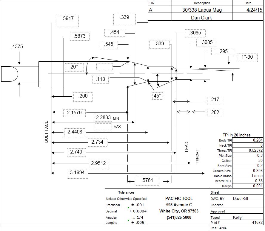

Is anyone else playing with the big 30's? I recently had Mark Pharr at Tumbleweeds build one for me, and we're starting to experiment with different loads. Both Retumbo and H1000 have shot well, but velocities are only in the 2750fps range.

I get 2925 fps out of my 300 WM with Retumbo and the 210 berger vld's. 2750 with a 338 case would make me think your chrono is way off or you have a lot of room to go yet. Goodluck.
Shooter here warren dean gets almost 3000 with 230 Bergers and a 300 win mag using retumbo. Try some slower powder
That should probably be close. Maybe a little more with the right powder, Freebore and barrel. Matt
Yes, I think there was probably 50-75 fps more in it but the freebore was defiantly not enough to maximize the performance on that particular gun.
I get 3200 with no pressure from a 215Hybrid with Retumbo, out of my .30-338 Norma Imp 30°, 28" Bartlein 1:10.
My smith likes 230s in his, and is running them @ 3075fps. Also, Retumbo...
To compare:
freebore of our wildcat reamer is .225" ( a bit short for the .230s)
Measured avg. H2o capacity of formed cases is 110.0gr
.300Lapua Mag is listed @ ~113gr
Dragman's recollection of 230s @ 3125 seems to be a safe & reasonable expectation for the .300 Lapua!
Reamer print here:
I guess the chrono could be off, but from what I've seen from Quickload it's right on the mark.
Barrel is 24" (had this one made with a shorter barrel because I'm running a suppressor).
COAL is in the 3.800" range.

Looks like you may want to try a case full of slower powder kissing the bottom of bullet .....
