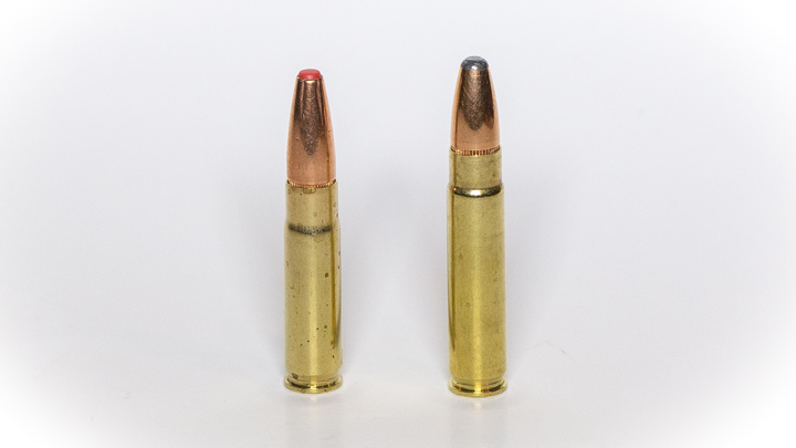

300 HAM’R Wilson Combat conversion
Came across this last night and am interested
I currently have a Ruger American in 300 aac and really like it
It is a deer thumper inside 100 yds and most loads I have developed for it shoot under an inch
I was wondering if anyone here had experience with the conversion and probably looking for a nudge ti do this .
But would like to head hands on experiences
I don’t have any doubts about the quality, was more curious about cartridge preformance
Thanks , Kenneth
I have not done the HAMR but have done a 30/223 if you would be interested in that info. Mine was done on a Savage 10.
So what’s the difference between the 399 aac and 300 hammer ?
Both cartridges being based on the 223 , was wondering were there was room for significant differences and curious about ballistics and any other pieces of knowledge you could put on me
Thanks , Kenneth
Worded that wrong , what I meant to ask was were did the 30/223 fit in at ? Would seem the 300aac and 300 Ham’r would not leave significant room for improvement in the 223 case
I’ll look into the 30/223 see what it’s all about
