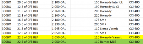

300 Blackout subsonic loading getting the best of me.
