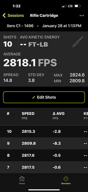

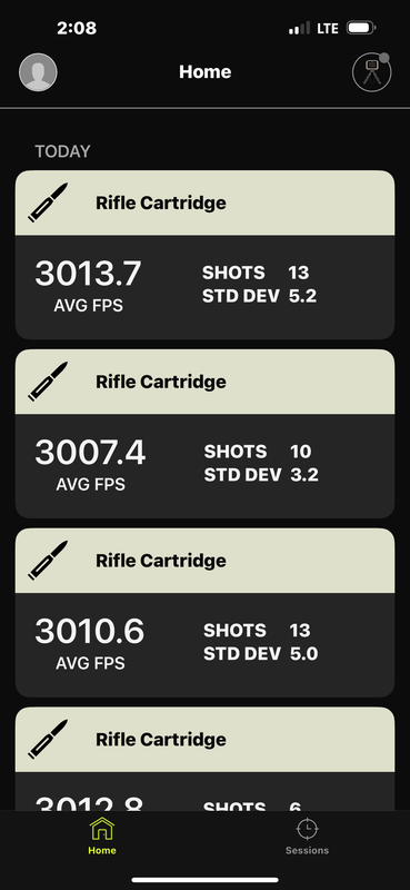

These are the stats from a local match. The velocity migration within a string isn't bad, but after 500 rounds it's up 50 fps from just after break in. I know from experience that after that, the vertical will soon open up beyond 2000 yards. So why isn't this setup more popular at KO2M? First, 30 cals are denied admission. Second, that velocity spread is about half again what a 375CT/400 Lazer combo will do with H50 and a 215M. Even with a fresh barrel, the BC spread also will be 2-3 times the Lazer. It will not actually score with the Cheytac beyond 3000 yards. Inside of 2500, it'll certainly leave a mark though.

These are the stats for a 300PRC with a 230ATip. It still has the Ruger barrel. I don't have any full match stats uploaded, but the 32" Barlein barreled 300 Lapua will only outscore it by 1 more hit in 10 on a 37" target at 2100 yards. Far enough out, when the RMS error budget curves are steep enough, the scoring differences open up. Those distances are far enough, that the number of hours in a year that the conditions are suitable for shooting those ranges are dropping faster than the barrel life.
