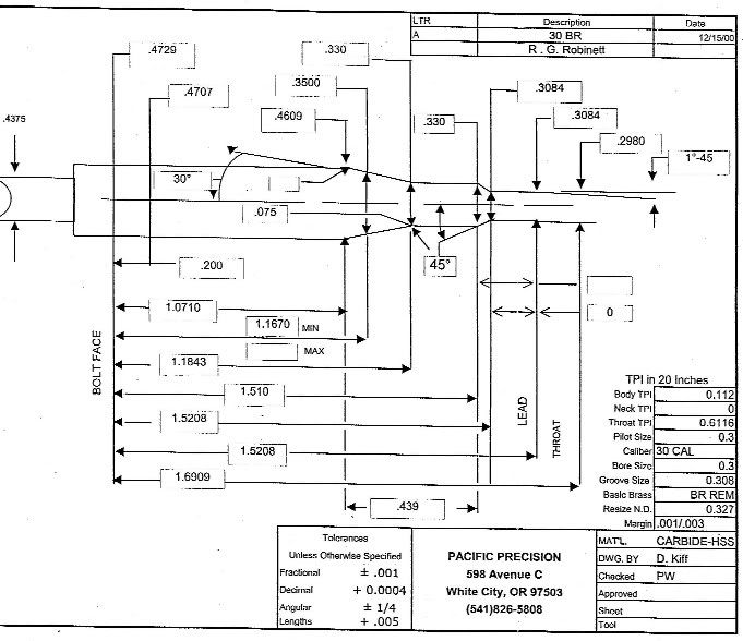

I've just chambered a 30 BR with a Robinette reamer from Pacific Tools. Can anyone help me with the reamer specs and more specifically how much neck turning I should do?
Isn't the neck diameter etched on the reamer? Randy's reamer spec is .330" neck, but others have used .332". You should contact Kiff and get the chamber print.
If its a .330" neck turn the brass so you have a .010" wall thickness then your loaded round should measure .228" I have found that if i set my Sinclair neck turner to the original brass at the neck skim right down the neck removing the Donut then set at .010" or even .0095" put a .010" feeler guage between the cutter and Mandrel and make it tight. My first attempt when i started wasn`t good and i left the necks a bit thick as i rushed and didn`t check and result was i was tearing the jacket on the projectiles take your time and do it right.

Bob, Kodiak & Wayne, thank you very much for the advise - I really appreciate it. I'm busy with the cases and will let you know how it goes.

Chris, did you receive my e-mail? Should you opt for longer/heavier bullets, for your sub-sonic loads,I'm assuming cast bullets of 165 Gr. or more), you'll probably need 0.150" or more free-bore. For bullets featuring ogive configurations of less than a,tangent)9 caliber radius, and made with jackets of 1.00" or longer, I don't believe you'll be happy with the short,ZERO)free-bore of the "Robinett" version of the 30BR. The ZERO free0bore is perfect for 7-8 ogive bullets based upon the .925" jacket length and for ten ogive bullets based upon the 1.00" long jacket; 1.00" long seven [tangent] ogive bullets still shoot well, but use up a lot of powder "space"! ;)R.G.

I however ordered the reamer for use in my 26 inch 1:17 twist Border barrel with 110/118gr bullets and in the second 22 inch 1:13 twist Palma barrel with 125gr bullets. I do not fully understand the technical info given by you, but will appreciate your advise and really hope the barrels will perform well in both the primary & secondary applications.
