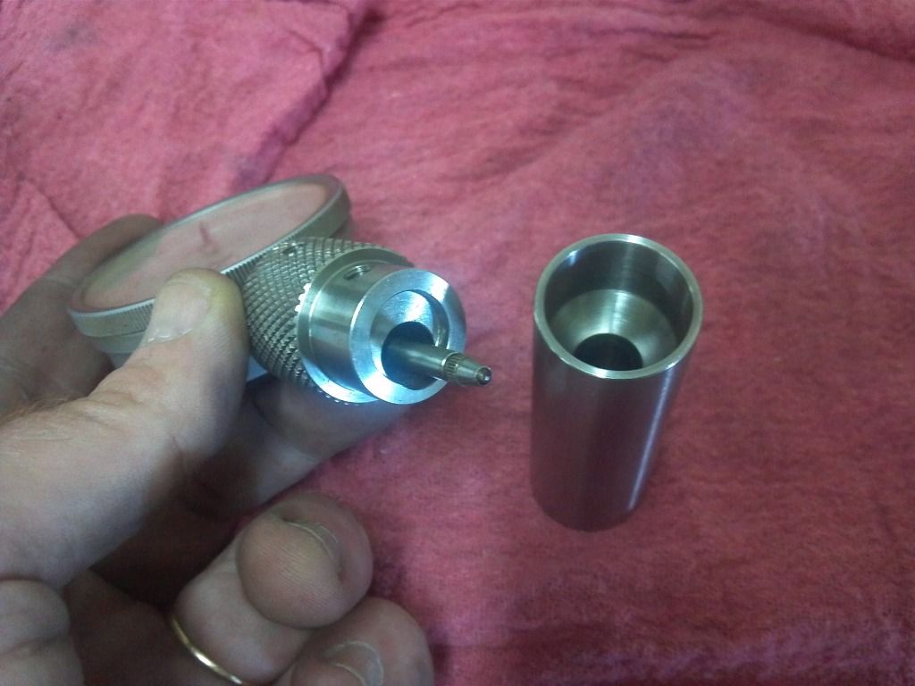

I posted this on the brc board, thought some may find it interesting here. Here's a gauge that I make for this purpose. It's fast, accurate and easy. Notice the indicator stem is offset to not be affected by the primer. Just drop the case in, mouth first and set the indicator top on the base. The base simulates the chamber, and measures from the shoulder to base. It's basically a long barrel widget machined for the indicator top. I use dial type indicators but digital indicators are an option and make reading and zeroing more convenient. It works with either equally well.

what do your sized case web measure?
.469 if I measured in the right place? Just above the grove.
