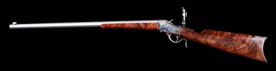

You can get this in 30-30. All you'll need is an MVA scope and mounts for optics.
I have had several 788s , and I never had a problem with any of them. I think that the problems that were discussed were mostly the result of calculations rather than actual experience. If a cartridge does not give problems, loaded to the point of blowing a primer, in a lever action, I am sure that it would not have any problem in a 788. BTW, in addition to having more bedding area than a 700, they have a slightly faster lock time, and are about four times stiffer. Their only weakness is the lack of an aftermarket trigger that is in current production. I found lighter springs for mine, and did some judicious stoning. Somewhere I have directions for modifying the stock trigger.
45bcpr, that is one fine looking piece of art, love to have one with the old 4x brass tube on it. And my 30-30ai was in a 336c, shot superb at 100yds 5 in a nickel not every time but most of the time if I did my job.
