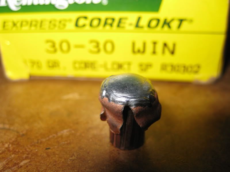

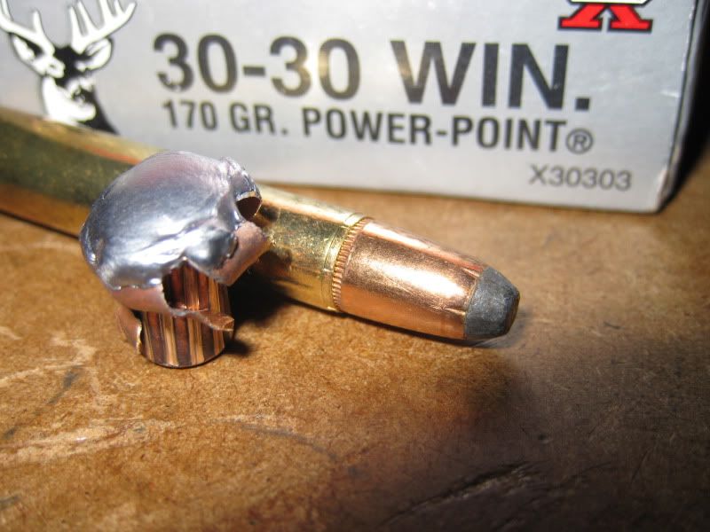

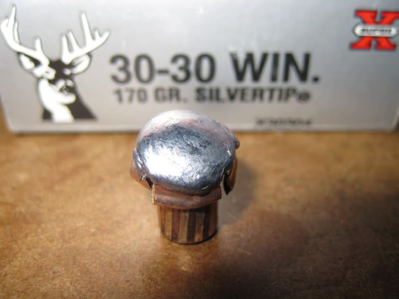

Standard round-nose soft-point .30-30 ammo is amazingly effective. A very well refined hunter's cartridge, easy recoil, heavy-duty results on target within the intended range of the .30-30 cartridge:
These were all captured after shooting them into one-gallon water-filled milk jugs. Penetration & expansion were excellent with all three bullets tested.
