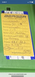

It’s never to old to talk about the 30-06.
From NC to Alaska the 30-06 has killed game for me. A late 1979 Win 70 XTR has been my 30-06 since high school that year. Love that rifle and IMR 4350 and Speer Hotcor in 165/180. Long Live the 30-06 !
