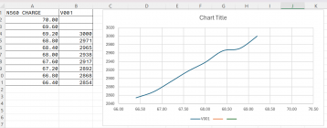

Because "ladders dont work" - I decided to shoot groups with my 300 WSM - A totally new cartridge to me. 66.4 gave me the smallest and very respectable group at 500 yards.
I just scribbled the avg velocity of each group in my book for that barrel. For the sake of ruffling feathers I just graphed it.
All roads lead to the flat spot. :eek:
I love it when things are thoroughly debunked, but are repeatable. :D
What is your 30 shot ES for this load? Apply appropriate error bars to this data and run a linear regression against the average.

Knowing a 3 shot series offers very low confidence for accuracy of the average, but working with the data on the page, the trend pictured above offers ~12-15ES throughout the trend, which, for small samples, suggests the SD for the population is likely 6.5-7fps ballpark (not the 3 shot sample SD, the predictable population SD), which corresponds to a population ES around 30-35 for larger strings. So dropping a rough average line and +/-15fps boundary lines, straight lines, essentially all shots fall within the linear prediction when we include inherent error possible for any shot. If the hypothesis that flat spots exist doesn’t even survive the most basic analysis, but the hypothesis that flat spots DON’T exist does persist, eh, I don’t really like lying to myself about what data tells me.

The first trend pictured above is a great example of WANTING to find patterns in data where none exists.
The same in the second - the guy mentions the starting load 66.4grn offered the best group, then points to an inflection deviation in a data set which traced a nearly perfect straight line, and pretends a node must exist around 68.5grn.

I'm not trying to change anyone's mind here, but I am the only one sharing data that is my own. Yes, the first graphs are biased because I was looking for flat spots; hell, sometimes I'd just fire into dirt and gather velocity data and go from there.
To remove that bias, I shot the 300WSM at a target and didn't even care to graph the data, but when I did... my chosen load fell on a flat spot. Is that "statistically relevant" to a statistician who doesn't shoot guns? No probably not. Is it a method that works for me? Yes. I don't care how or why it works. But it sure is weird that it works over, and over, and over again.

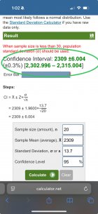

An SD of 14.9 across 20 rounds or 13.7 across 20 is roughly 3x looser than the SD I used to analyze your data trend above. The yellow lines would be 3x wider, with ALL shots within those boundaries being valid predictions (proportionately distributed, of course) for actual velocity opportunities. In other words, I applied a linear regression with a tighter standard, about 3x tighter than your actual loads, and the linear regression fit your data. Applying even looser SD standard would only improve the fit of the linear regression and further confirm the flat spots are anomalous.
(Recognizing this is 500yrd data and Bc variability is influencing the read velocities, so the 500yrd SD may not align with the muzzle SD).
As another confirmation of inherent error possible the data readings is the fact two of those strings were fired only an hour and 6min apart, but read 6fps difference in average velocity. So both averages - the 2309 and 2315 actually are within the same inherent error of the load you were shooting, and on a total set,
So based on that data alone, there remains a ~7fps overlap where your true average for that population of ammo exists, but there’s no way to tell what the actual average for that ammo really is… but we sure want to tell ourselves 2309 or 2315 are the true averages.

With greater than 99% fit, here is some of my load development data with a linear regression applied.
I COULD look at the few places where flat spots seem to repeat, letting my primitive human instinct seek out patterns and then tell my advanced logical faculties that those patterns mean something, OR, I can avoid lying to myself, apply even the most rudimentary error projection to the analysis, recognizing that “standard deviation” measures how far any given shot is likely to be from truth, and accept that a straight line fits nearly perfectly.
