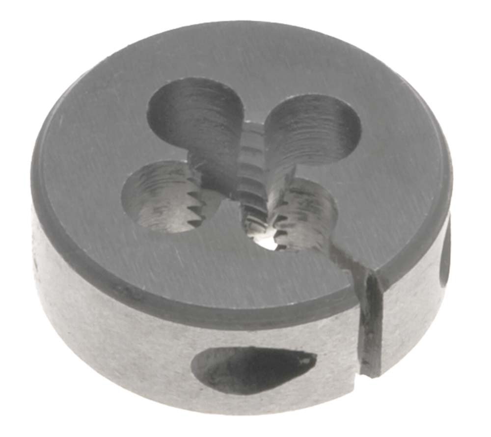

Is there an easy fix for this or does it have to go back to the gunsmith.
Is it possible to just buy a 3/4-24 thread die and run it down the barrel threads?

Do you think it would be possible to use a hand die without a lathe?

I’d put it back in the lathe and recut the thread but I don’t see any reason you couldn’t use a die. The thread is established already the die is going to follow it. I would get an adjustable split die and creep up on proper fit. A quick search shows dies available
That is what I was thinking. It may be worth trying. What is the worst thing that could happen?

An adjustable die will take care of the issue in about 2 minutes and do a excellent job doing it. Start loose and continue to decrease the size until that pesky last .001 comes off. Available in 3/4 X 24.
