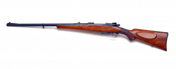

It’s been a long road. 9 month wait on the stock, etc, etc. Hopefully weather cooperates and I can get a few rounds through it tomorrow. The scope set me back on weight. It is 11.4 lbs ready to hunt with bipod and can. We will be using it on my son’s elk hunt in October. We will see how it goes.
They almost always wind up heavier than we think. I just finished one and hoped for under 9 lbs. It's just over by about an ounce. I actually figured on an 8.5 lb gun. Weighing all the parts came in under 9 but after assembly went over.
