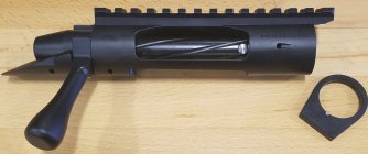

It’s about to get real. My throat reamer from PTG arrived. I need to go get some 195gr EOL’s and some cutting oil. I’m going to take off .020 and just sneak up on it from there. Measure both bullets as I go.8978BF23-F04F-4349-BB79-CE8D3B02EBAA.jpeg
My rifles throat is .110 longer than saami. Its set up for 195's to be just right. The 180 Bergers bearing surface would be 1/3 of the way up the neck. I plan on using the 195 Bergers and 177 Hammers.
Throating the barrel went well. I went slow. Final results are a little different than I imagined due to the different ogive shape of the two bullets I was using. The lands for the 195 put me at 3.725" COL give or take a few thou due to bullet tip differences. That gives me .025 clearance in the mag at the lands. The 175 ELDX ended up at the lands at 3.590" COL give or take. The reamer was super sharp, of course, and cutting was easy. Can't wait to get the action.69F9697E-B024-43BC-A966-764421AF88BE.jpeg1FE7FF8C-C3F4-4C0B-8B93-9DE7FE5A5130.jpeg56A36769-4A18-4CE7-977F-CD2232A322DD.jpeg56F23B03-0C84-4C36-B50F-596570872DEC.jpeg
