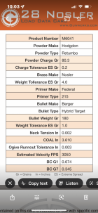

FWIW, here's the GW factory load. Disclaimer: It was pretty warm in my opinion/rifle, but shot very well.
