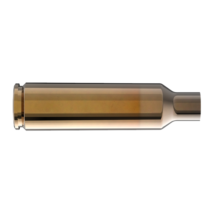

Problem: Need more brass for 270 WSM hunting rifle. I LIKE shooting it recreational and maybe shoot 100-200 shots a year. I have about 90 Winchester brass but they have seen 4-5 firings and are starting to split necks.
Solutions:
1. Pull factory ammo to get brass?
2. Shoot factory ammo to get brass?
3. Try and sell the ammo that doesn't shoot and buy new brass? (probably ideal but inexperienced with selling things like ammo)
3a. For 270 WSM brass what brand is good, I don't need best. So far I can find Norma, Nosler, ADG, & Hornady.
4. Something i'm missing. (tossed around rebarreling to remove 270 WSM from my life altogether but i have a LOT of ammo for this gun)
Facroty ammo I have that doesn't shoot worth a dang.
Federal Terminal Acent 136gr
Win Deer Season XP 130gr
Fed Fusion 130gr
Fed Power Point 130gr
First, learn to Anneal! Pull that factory stuff apart, dump the powder unless you KNOW what it is and use the bullets as foulers. Maybe try some loads with the bullets if you have a lot of them.
YES! I started annealing recently. These handloads are from when i was young, dumb, and ... didn't know annealing was a thing or anything about brass life & consistency. I assumed i could always just get more. 15 years ago 270 WSM was everywhere and was cheap.
Buy ADG 270 WSM Brass and dont look back
Lapua 300 WSM brass and neck it down.
ADG gets good reviews as does Lapua. Are either choice good?
Only knock on the 300 WSM is I'm new to changing a case from one size to another. Would I need a special die to do that?
Save yourself the trouble of Necking down which its reallnot that big of deal i necked down ADG 300WSM brass for my 6.5x300wsm and do others because I have to in your case I wouldn't if I could get quality brass
If it is a bench gun and you are going to have a good chance of retrieving your brass, by all means get the best. If this is a hunting rifle and will be shot mostly in the field chances are you will lose most of it in the high grass, and you may not want to eject the premium brass into the wilderness.
